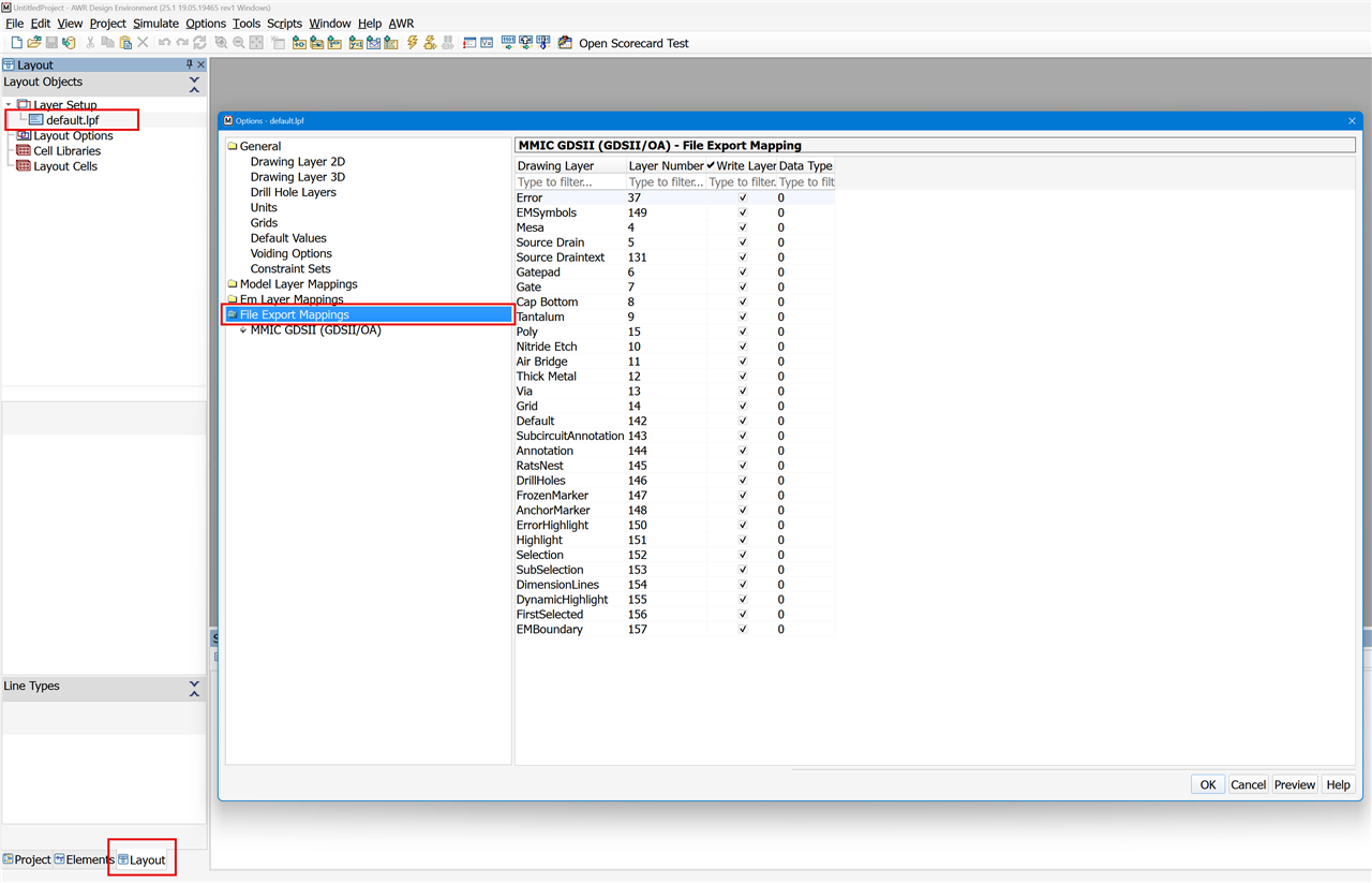

I've created a new project, drawn what I need, but now the only option to export is GDS.
I need dxf but this is not available. dxf still shows on older projects that I have.
What do I need to do to make dxf available?

  • CurtisAWR
    0 CurtisAWR 7 months ago in reply to NV202504147220
    I concur with the statement in the previous answer that the lack of a DXF or Gerber mapping definition may be the issue here.
    Below is a screenshot showing typical Export Mappings that may appear when first opening a new project.  As you can see, a MMIC GDSII (GDSII/OA) export map exists, but DXF and Gerber export maps have not yet been defined.  In this case, the user would need to create one.

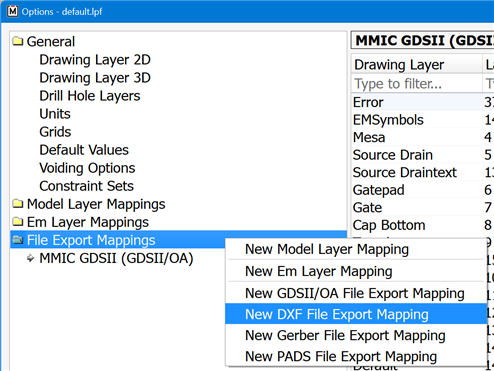

    To do so, you can right-click on the File Export Mappings node and select one of the options (see below):

    Just a few points:
    • If you go to "AWR Microwave Office Layout Guide," section 4.4 "Exporting the Layout," this subject is covered.
    • While the DXF map (in this case) is not provided from the beginning, the process of creating the map (and accepting the automatically-generated defaults) is very simple, and takes only a few seconds.  Most users have no problem with the process.
    • In some cases (such as the following), DXF maps are generated automatically:
      • Foundry-provided PDKs often have DXF mappings provided.
      • If you start your project with any of the AWR Example Processes (with the exception of AWR MESFET), a DXF export map is provided.
      • If you use the Create New Process tool (Tools > Create New Process), the resulting LPF includes a DXF export map.
