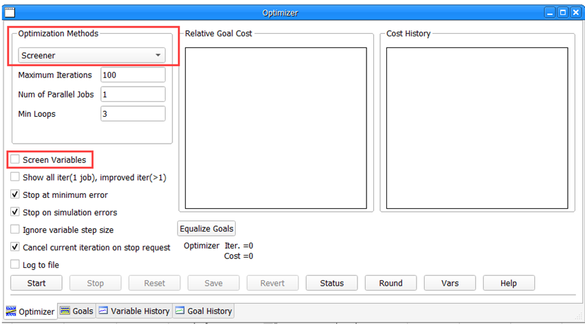

Microwave Office & VSS v25.1 New Features- Optimizer Improvements
SandyRF
SandyRF 4 months ago
Microwave Office & VSS v25.1 New Features for Optimizer Improvements includes-
  • A new Screener optimizer method that is suited for designs with many variables.
  • A new Screen Variables option for sampling the variable space for a good starting point before employing the optimizer.
  • An alternative Normalized Difference cost function for goals.
