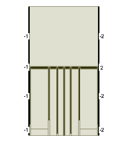

Hello to everybody.
I have some concerns about the correct definition of ground in a CPW configuration defined within the AWR Microwave Office AXIEM simulator.
In the past years, I received the suggestion to use differential ports, like "1" for the signal and "-1" for the lateral ground. Of course, the same for port "2" or others. Reading again a post on this Community I have seen that somebody suggests to use "1" for the signal and "2" for the lateral ports. So, is it the same or one is better than the other?
Again, when a CPW grounded (GCPW) is studied, is it sufficient to use a metal on the bottom boundary or it must be connected to the surface using via holes to have the metal surfaces at the same potential, i.e., ground?
To end, I noticed that adding pieces of metal and making the union of them does not involve a redefinition of the metal sheet as a whole, because if such a metal is close to the I/O ports of the CPW structures, I am forced in filling all the side with the "-1" port to confirm. It seems that apparently I have one metal sheet, but in fact putting a differential port where I added some metal maintains the memory of the past configuration, forcing me in extending the "-1" definition to such a ghost metal... like in the figure attached.

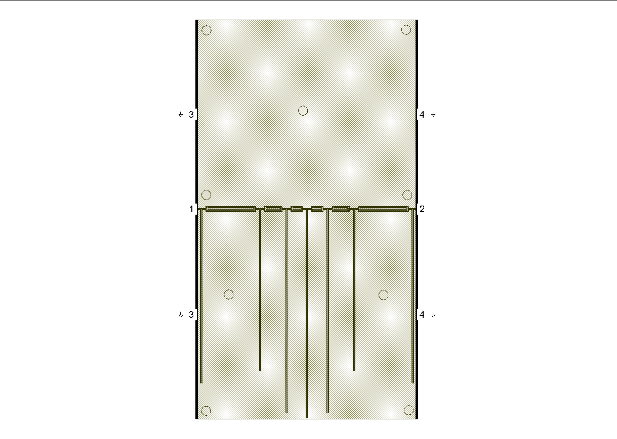

    Thank you for your reply. Actually, I was thinking that a "connect to lower" statement would be enough to satisfy the condition that you are suggesting. To be redundant, I used also additional via holes on the upper metal sheet, connected to the lower metal boundary, as you can see in the figure.

    By the way, to eliminate the problem of "metal union" still maintaining the memory of the previous separated metals, and forcing me in defining additional differential ports, I simply added a metal having the right size to close the metal boundary and now the differential ports is automatically extended over the entire section.

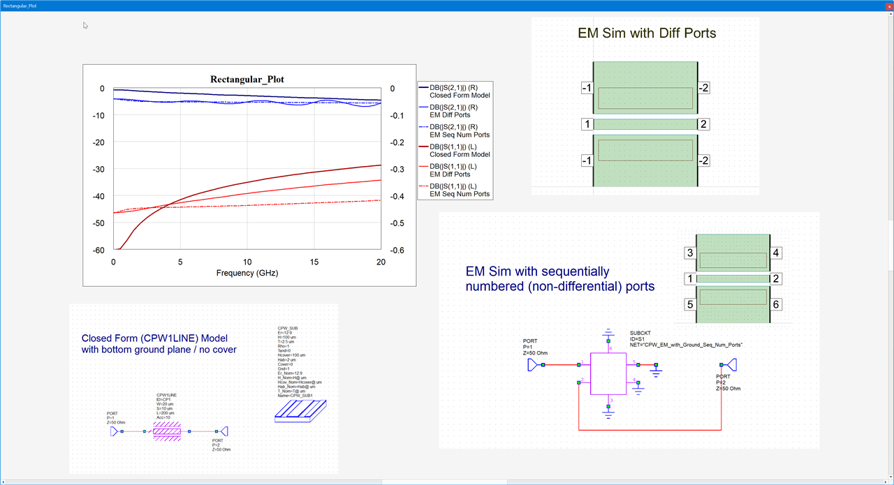

    Are you seeing disagreement between the various modeling methods?
    Below are shown the results of a quick-and-dirty simulation of a CPWG transmission line, using the AWR MESFET example process.  The dimensions are W=20, S=10, and L=200, and the EM simulator chosen is AXIEM.
    The darker trace in each group is the Closed Form (CPW1LINE) model with Acc=10, and the other traces reflect the EM structure modeled with differential ports, as well as sequentially numbered ports, grounded at the schematic level.
    The agreement between the two EM simulations is very good.
    Are you seeing disagreement with your particular structure?  I guess if you are, I would encourage you to file a support case so that Cadence can troubleshoot it with you.
  • CurtisAWR
    CurtisAWR 7 months ago in reply to CurtisAWR
    And just one added point regarding my previous post:
    Grounding or floating Ports 3-6 in the schematic with the 6-port EM structure (with sequentially-numbered ports) resulted in a very minimal change in simulation results, since the rectangular ground bars I've added rather robustly connect the topside grounds to the backside ground plane.

    Hi, I am still studying the differences between CPW and CPWG with Microwave Office AXIEM. Actually, for CPWG I solved the simulation problems using a number of via holes physically connecting the lateral ground plane on the top of the substrate with the bottom metal, to assure a ground to the studied structure. Nevertheless, I have a few conceptual problems: (1) the presence of via holes solved for me the comparison between a semi-lumped approach simulated circuitally (where the parameter GND=1 emulates the CPWG library elements) and the electromagnetic result; but, is this only a SW problem, or experimentally, I really need the via holes? (2) If I am simulating the simple CPW, is the differential port definition enough to have a "real" result, or do I also need more specific boundary conditions to try a direct comparison with the experiment?

    • 1.  No, this does not appear to be a software issue; it is related to the experimental setup. The software attempts to emulate the experimental conditions.
    • 2.  The boundary conditions defined in the experimental setup should be replicated in the software. For simulation purposes, a differential port is sufficient.
  • Romolo Marcelli
    Romolo Marcelli 5 months ago in reply to OscPn
    Thank you very much. This actually means that a CPWG probably needs a few via holes along the path to ensure the ground conditions.
