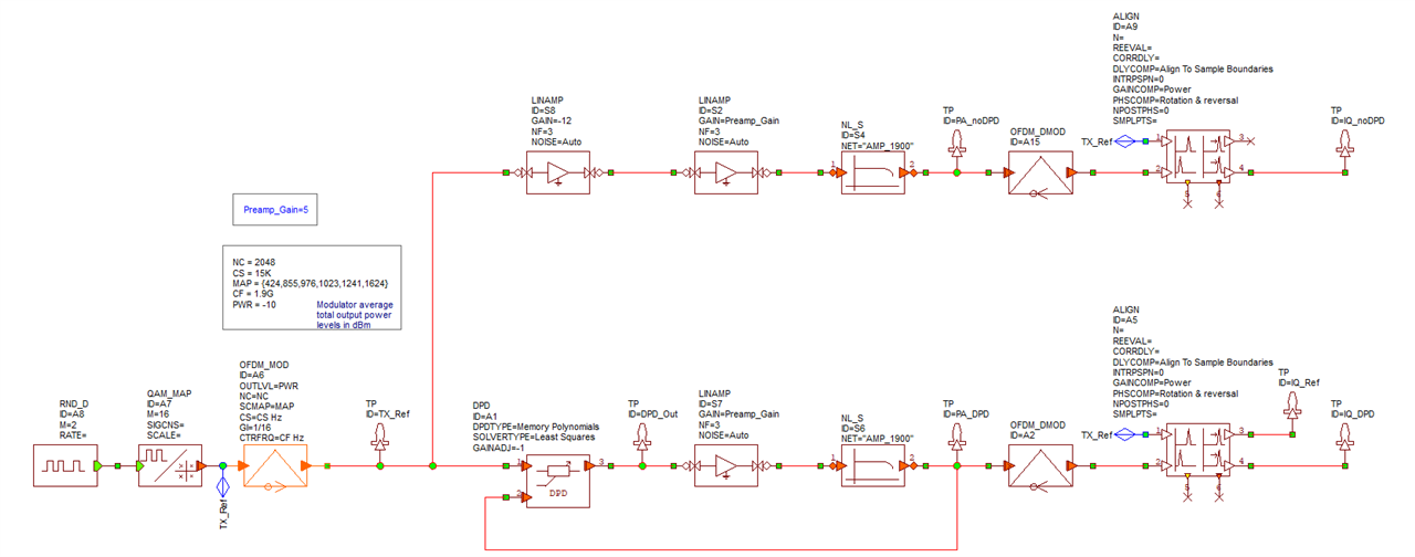

Digital Predistortion Testbench Overview
Figure 1: Closed‑loop DPD testbench integrating OFDM stimulus and nonlinear PA circuit
The DPD demonstration uses a VSS‑based system‑level testbench driven by a realistic OFDM waveform configured for multiuser operation. The signal chain includes:
  • OFDM source in VSS
  • Driver amplifier
  • Nonlinear power amplifier implemented as a Microwave Office circuit schematic
  • Closed‑loop DPD block using feedback from the PA output
This approach enables seamless co-simulation of RF circuits and digital signal‑processing algorithms within a single environment.

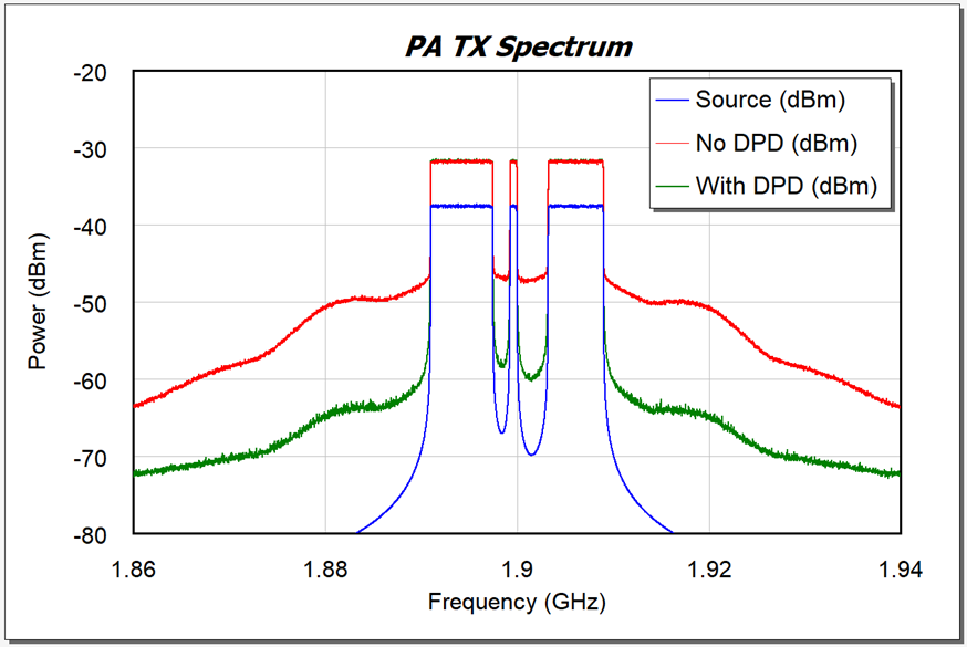

  • Reduced spectral regrowth, improving adjacent‑channel performance.
Figure 2: PA output spectrum showing reduced spectral regrowth with DPD enabled

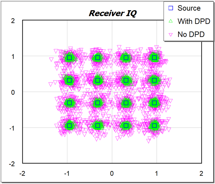

  • Cleaner IQ constellation, indicating improved EVM.
Figure 3: Improved IQ constellation with DPD, indicating reduced EVM

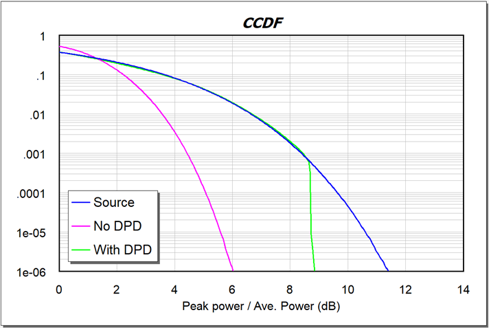

  • Improved CCDF characteristics, reducing peak power excursions.
Figure 4: CCDF comparison shows reduced peak power excursions with DPD
