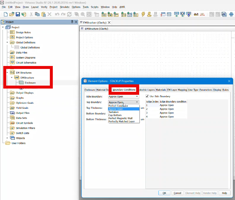

Truing to enter AWR MWO simulations based on past experience and general knowledge seems to be pretty steep. On the other hand I could not find a similar example, so I could look into it first. So I am asking community to suggest example or the topics to be studied first.
I want to use AWR MWO to study microwaves reflection from surfaces, like m/w absorber being illuminated by plane wave as a very first problem. I see many examples for circuits simulations, here I'd like to learn, how to simulate kind of distributed system, ideally estimate its characteristics, like S11.
Please suggests initial steps.

    0 CurtisAWR 5 months ago
    I suspect you will need an EM solver like Analyst / Clarity, or at least AXIEM, to effectively model the effects of a lossy boundary like an absorber.

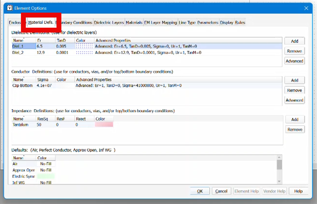

    You could create a 3D EM Structure and then open its Enclosure node -- and then go to the Boundary Conditions Tab -- to set the way in which the structure's boundaries are terminated.  You can of course set them as Open or Perfect Conductor, but you can also set them to be a material which you specifically define in the Material Defs. tab of the STACKUP.
    See screenshots below.

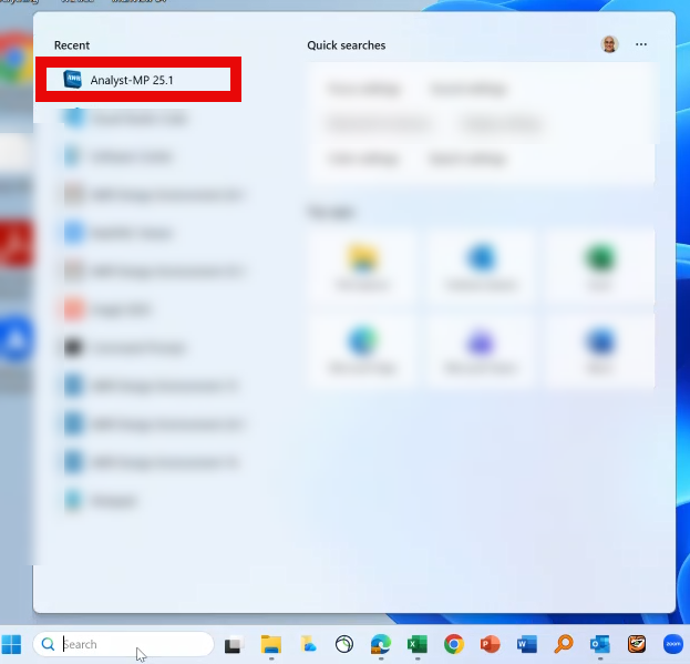

    You can try using the Analyst-MP application instead of through MWO.  In that program you can set up ports and run simulations without needing to start in MWO.  You would need specific Analyst-MP features in your license file, which I am assuming you have.
