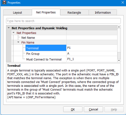

Layout Pin Names Property in AWRDE 25.1
SandyRF
SandyRF 5 months ago
A new layout shape Pin Name property supports more complex pin connectivity configurations. Individual shapes or layout instances can be turned into physical pins in layout by setting the Pin Name parameters on the shape Properties dialog box Net Properties tab. This pin model is recommended for Virtuoso Studio RF users who want to create IP that is interoperable with Virtuoso Studio as the new pin model uses the same connectivity model that Virtuoso Studio uses.
