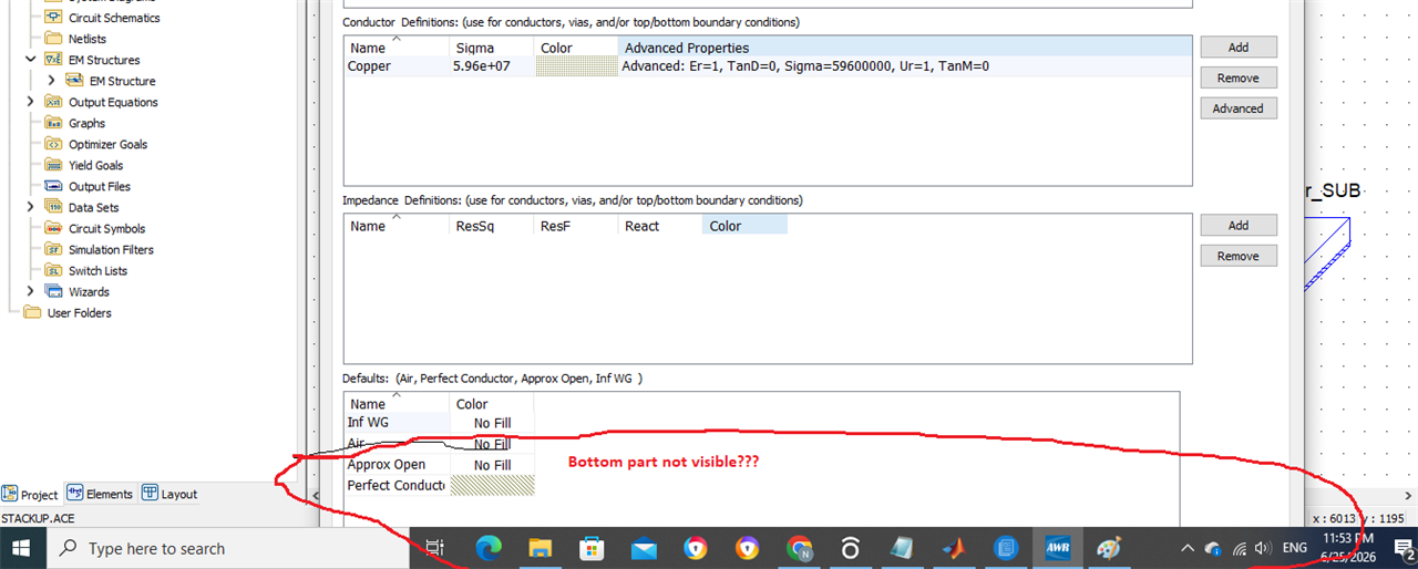

I am currently using AWR Design Environment 24.1 (licensed version), but I am facing an issue related to the layout and substrate definition interface.
Specifically, I am unable to define the stackup and substrate parameters because the lower portion of the relevant window is not visible. It appears to be cut off or hidden, and I cannot scroll down or access the bottom section where those settings are normally located.
In addition, the window itself cannot be resized, which makes it impossible to adjust the view or access the missing controls.
Has anyone encountered this issue before, and is there a known fix or workaround (e.g., display settings, DPI scaling, or UI reset)?

    Are you using a laptop?
    If so, the display resolution may not be high enough. Please try increasing the display resolution (preferably 1400 × 900 or higher) in the Windows Display settings. Alternatively, you may use an external monitor for better resolution.

    Yes.I am using a lap top.I have tried chamging the resolution.but still not fixed.
    I will try with an external monitor.
