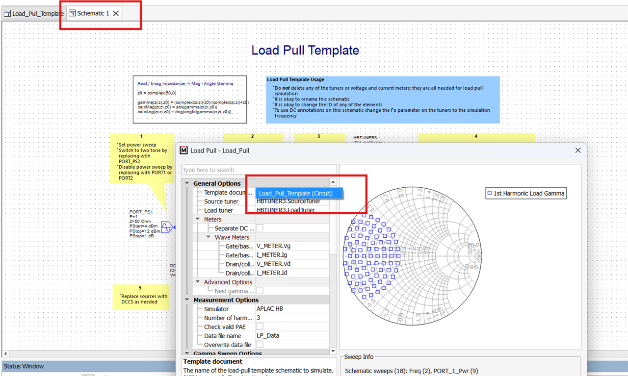

Load Pull Template Not Recognized After Copying to New Schematic
AnalogMonk
AnalogMonk 1 month ago
When I copy the Load Pull template content from the wizard into a new schematic, AWR no longer recognizes it as a template document. What is the correct way to reuse a Load Pull template across multiple schematics or projects?
  • RfJosh75
    0 RfJosh75 1 month ago
    The schematic needs to be copied (Right-click -> Duplicate, drag to the "Circuit Schematics" node, etc.) rather than the contents.
