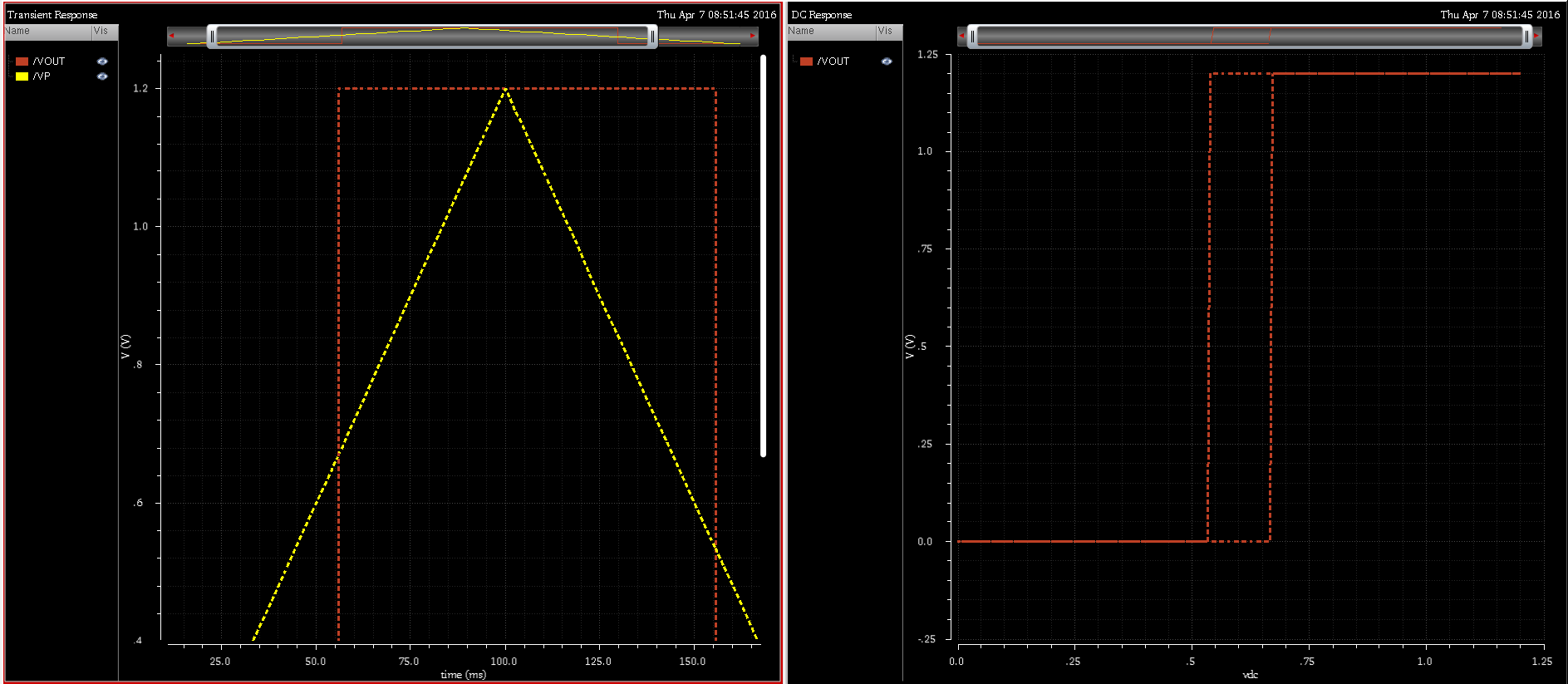

Hysteresis sweep option in DC
sohaiba
sohaiba over 13 years ago
I haven't been able to see a Hysteresis plot by using the DC Hysteresis sweep option. I have also enabled the 'DC operating point' option as well. I was expecting to find a negative going plot as well for the device but there is only a single Voltage transfer characteristic curve.
 Following are the settings the Cadence spectre.out shows.
Important parameter values:
    reltol = 1e-03
    abstol(V) = 1 uV
    abstol(I) = 1 pA
    temp = 120 C
    tnom = 27 C
    tempeffects = all
    gmindc = 1 pS
    hysteresis = on
Which verifies that hysteresis option is "ON".  I am using MMSIM 11.1 and Cadence 6.1.5. Could you indicate where I could be going wrong?

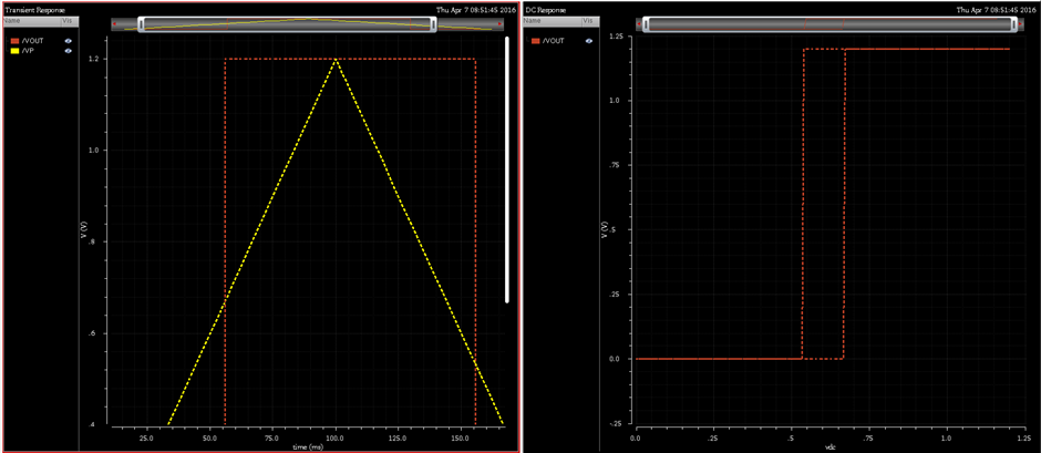

    Well, thanks a lot. This is the first time I run something like this. It looks professional!
    I have just followed your instructions and it works nicely.
    So hope you have some idea why my hysteresis in DC analysis doesn't work now.
    For MMSIM I am using MMSIM13.11.
    No, I have no idea why your hysteresis isn't working. You still haven't specified the exact version number (this will appear in the spectre log file). However, since my example works, it's unlikely to be a generic bug in the simulator.
    The only next step is to see either the complete spectre log file (you didn't post that - especially the bit showing the dc analysis), and better still the actual input.scs. If you can't post that here, you'll need to follow this up through your University support channel (as we've discussed before).

    DC Analysis `dcOp'
        reltol = 1e-03
        abstol(V) = 1 uV
        abstol(I) = 1 pA
        temp = 27 C
        tnom = 27 C
        tempeffects = all
        gmindc = 1 pS
    Convergence achieved in 10 iterations.
    Total time required for dc analysis `dcOp': CPU = 2 ms, elapsed = 2.2881 ms.
    Time accumulated: CPU = 405.938 ms, elapsed = 736.436 ms.
    Peak resident memory used = 62.3 Mbytes.
    dcOpInfo: writing operating point information to rawfile.
    DC Analysis `dc': vdc = (0 -> 1.2)
        reltol = 1e-03
        abstol(V) = 1 uV
        abstol(I) = 1 pA
        temp = 27 C
        tnom = 27 C
        tempeffects = all
        gmindc = 1 pS
        hysteresis = on

    INPUT.SCS
    // Generated for: spectre
    // Generated on: Apr  6 19:23:51 2016
    // Design library name: Huan
    // Design cell name: Hys_Comp
    simulator lang=spectre
    global 0 vdd!
    parameters vdc=0.6
    include "/root/Design6/Simulation_Efficiency/TSMC18/tsmc18rf/../models/spectre/rf018.scs" section=dio3
    include "/root/Design6/Simulation_Efficiency/TSMC18/tsmc18rf/../models/spectre/rf018.scs" section=dio_dnw
    include "/root/Design6/Simulation_Efficiency/TSMC18/tsmc18rf/../models/spectre/rf018.scs" section=tt_rfres_sa
    include "/root/Design6/Simulation_Efficiency/TSMC18/tsmc18rf/../models/spectre/rf018.scs" section=tt_rfmvar
    include "/root/Design6/Simulation_Efficiency/TSMC18/tsmc18rf/../models/spectre/rf018.scs" section=tt_rfind
    include "/root/Design6/Simulation_Efficiency/TSMC18/tsmc18rf/../models/spectre/rf018.scs" section=tt_rtmom
    include "/root/Design6/Simulation_Efficiency/TSMC18/tsmc18rf/../models/spectre/rf018.scs" section=tt_bbmvar
    include "/root/Design6/Simulation_Efficiency/TSMC18/tsmc18rf/../models/spectre/rf018.scs" section=tt_rfesd
    include "/root/Design6/Simulation_Efficiency/TSMC18/tsmc18rf/../models/spectre/rf018.scs" section=tt_mim
    include "/root/Design6/Simulation_Efficiency/TSMC18/tsmc18rf/../models/spectre/rf018.scs" section=tt_rfrtmom
    include "/root/Design6/Simulation_Efficiency/TSMC18/tsmc18rf/../models/spectre/rf018.scs" section=tt_rfres_hri
    include "/root/Design6/Simulation_Efficiency/TSMC18/tsmc18rf/../models/spectre/rf018.scs" section=tt_rfres_rpo
    include "/root/Design6/Simulation_Efficiency/TSMC18/tsmc18rf/../models/spectre/rf018.scs" section=tt_3vna
    include "/root/Design6/Simulation_Efficiency/TSMC18/tsmc18rf/../models/spectre/rf018.scs" section=tt_rfmos
    include "/root/Design6/Simulation_Efficiency/TSMC18/tsmc18rf/../models/spectre/rf018.scs" section=tt_rfmim
    include "/root/Design6/Simulation_Efficiency/TSMC18/tsmc18rf/../models/spectre/rf018.scs" section=tt_rfjvar
    include "/root/Design6/Simulation_Efficiency/TSMC18/tsmc18rf/../models/spectre/rf018.scs" section=tt_3m
    include "/root/Design6/Simulation_Efficiency/TSMC18/tsmc18rf/../models/spectre/rf018.scs" section=tt_res
    include "/root/Design6/Simulation_Efficiency/TSMC18/tsmc18rf/../models/spectre/rf018.scs" section=tt_bip3
    include "/root/Design6/Simulation_Efficiency/TSMC18/tsmc18rf/../models/spectre/rf018.scs" section=tt_rfmos33
    include "/root/Design6/Simulation_Efficiency/TSMC18/tsmc18rf/../models/spectre/rf018.scs" section=tt_na
    include "/root/Design6/Simulation_Efficiency/TSMC18/tsmc18rf/../models/spectre/rf018.scs" section=tt_rfsbd
    // Library name: Huan
    // Cell name: Hys_Comp
    // View name: schematic
    V4 (VP 0) vsource dc=vdc type=dc
    V3 (net22 0) vsource dc=600.0m type=dc
    V1 (VN 0) vsource dc=600.0m type=dc
    V0 (vdd! 0) vsource dc=1.2 type=dc
    M10 (VOUT net01 0 0) nch l=1u w=350.0n m=1 ad=2.114e-13 as=2.114e-13 \
            pd=1.88u ps=1.88u nrd=0.885714 nrs=0.885714
    M8 (net01 net01 0 0) nch l=1u w=350.0n m=1 ad=2.114e-13 as=2.114e-13 \
    M6 (net25 VP net19 net19) nch l=1u w=350.0n m=1 ad=2.114e-13 as=2.114e-13 \
    M3 (net24 VN net19 net19) nch l=1u w=350.0n m=1 ad=2.114e-13 as=2.114e-13 \
    M0 (net19 net22 0 0) nch l=1u w=350.0n m=1 ad=2.114e-13 as=2.114e-13 \
    M9 (VOUT net25 vdd! vdd!) pch l=1u w=350.0n m=2 ad=1.232e-13 as=2.114e-13 \
            pd=1.04u ps=1.88u nrd=0.885714 nrs=0.885714
    M7 (net01 net24 vdd! vdd!) pch l=1u w=350.0n m=2 ad=1.232e-13 as=2.114e-13 \
    M5 (net24 net25 vdd! vdd!) pch l=1u w=350.0n m=1 ad=2.114e-13 as=2.114e-13 \
    M4 (net25 net25 vdd! vdd!) pch l=1u w=350.0n m=1 ad=2.114e-13 as=2.114e-13 \
    M2 (net24 net24 vdd! vdd!) pch l=1u w=350.0n m=1 ad=2.114e-13 as=2.114e-13 \
    M1 (net25 net24 vdd! vdd!) pch l=1u w=350.0n m=1 ad=2.114e-13 as=2.114e-13 \
        checklimitdest=psf rampsource=no
    dcOp dc write="spectre.dc" maxiters=150 maxsteps=10000 annotate=status
    dcOpInfo info what=oppoint where=rawfile
    dc dc hysteresis=yes param=vdc start=0 stop=1.2 lin=200 oppoint=rawfile \
    subckts info what=subckts  where=rawfile
    I checked in MMSIM14.1 ISR17 with your circuit. I added a transient analysis too - I changed V4 to:
    V4 (VP 0) vsource dc=vdc type=pulse val0=0 val1=1.2 rise=1m period=2m width=0 delay=0
    and added:
    dc dc hysteresis=yes param=vdc start=0.5 stop=0.7 lin=200 \
    tran tran stop=2m
    (the dc is narrower - I removed the oppoint just in case but I don't think that's critical). Here's what I got:
    If I really zoom in you can see there's a tiny amount of hysteresis. From the transient slow ramp up and down of VP, there appears to be no significant hysteresis in the circuit (the transition is almost exactly at 0.6V for rise and fall ramp).
    So are you sure your circuit actually exhibits hysteresis?
    BTW, I just re-tested in 13.1.1.049 and see identical results to the above picture.

    I have just run as your setup. However, the hysteresis doesn't show in DC analysis (it is really small but it has).
    Here is the result when I run.
    With transisent, I convert it using Y vs Y and the hysteresis shows but as you say it is very small.
    The DC analysis shows nothing. I zoomed it in but couldn't see any.
    I don't think that's hysteresis you're seeing in the transient. If you change the period of the ramp, the size of the "eye" in the transient reduces - suggesting that it's a capacitative effect rather than hysteresis.
    In other words, if you change:
    V4 (VP 0) vsource dc=vdc type=pulse val0=0 val1=1.2 rise=100m period=200m width=0 delay=0
    and then run the transient for 200m instead of 2m. The gap is significantly smaller.
  • BaaB
    BaaB over 10 years ago
    You are an expert! I changed some parameters of the circuit and now I can see hysteresis in both transient and DC analysis now.
    Just curious, is there a concept "size of the eye" used in the software or in a particular analysis?
    The "size of the eye" was a throwaway comment because the graph is somewhat like an eye diagram (not really because that's usually for clocked systems where you have jitter causing the position of edges to move back and forth). With eye diagrams you have the idea of an eye width - but that's not how you'd measure it here.
    You can measure the width of the opening - which corresponds to the hysteresis - by doing something like:
    cross(v("/VOUT" ?result "dc") 0.6 1 "rising" nil nil  )-cross(v("/VOUT" ?result "dc") 0.6 1 "falling" nil nil  )
    Note that the resolution will be limited to the step size you use in the dc sweep.
