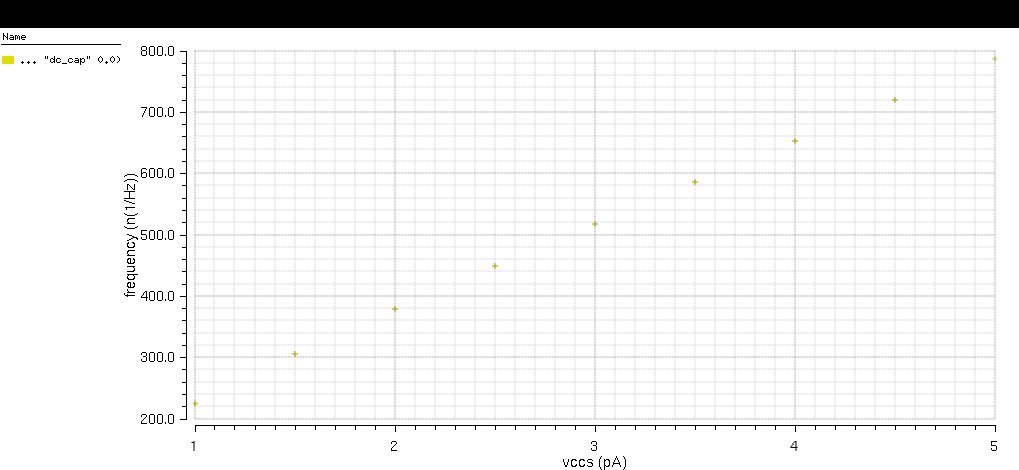

    I am really sorry to disturb you again, but the picture I get is not a discrete graph as shown below. This is confusing as I set all capacitor values at discrete values at certain time point in the dynamic variable vector. However, the results give me continuous graph in oppoint against time. I set infotimes to save these oppoint. May I ask if there is any way of plotting frequency against discrete lx0?
    Thank you very much!
    Best Wishes,
    Mingqiang
  • ShawnLogan
    ShawnLogan over 5 years ago in reply to EEE student
    Dear Mingqiang,
    Did you right click on your plot of capacitance versus time and choose "Type->Points" and, also from a right click, "Symbols on". This will only display the values without any line between data points.

  • EEE student
    EEE student over 5 years ago in reply to ShawnLogan
    Hi there,
    Here is a quick update. I successfully plotted the stuff using your method. I have attached it for your reference! Thank you very much!
