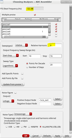

    This too is killing me - I did the next test by adding a div-by-8 after the VCO:
    - beat-freq=12.5MHz
    - tstab is changed from 100ns to 800ns
    - PNOISE is setup with multiple noise simulations 2x phasenoise and 2xsampled-jitter for VCO and DIV8 out.
    - PNOISE harmonic for VCO-out is set to "8", harmonic for DIV8-out is set to "1"

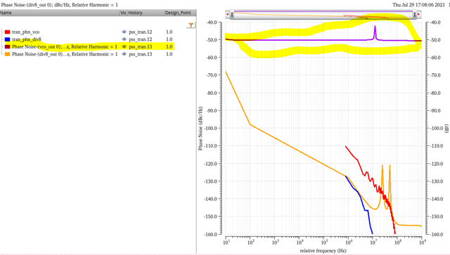

    Now the pnoise2 result is NOT showing the proper phase-noise plot anymore - it is selecting the harm=1 instead of harm=8 when plotting with direct plot and the values is constant at -50dBc/Hz - why ?
    The phasenoise for the DIV8-output is matching well with the transient phasenoise.

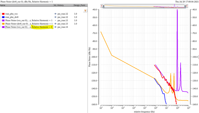

  • HoWei
    HoWei over 5 years ago in reply to HoWei
    Doing a single (not multiple )noise analysis with the same settings, then the phasenoise plot selects the 8th harmonic and shows the correct results
    This clearly seems to be a bug, right ?
  • Frank Wiedmann
    Frank Wiedmann over 5 years ago in reply to HoWei
    It looks like the plotting interface is getting confused by the multiple noise simulations. You should probably report this to Cadence Support.
