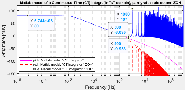

#3b) ... try model over Continuous-Time (CT) with subsequent sampling:
Now I would like to model the real circuit from #2 over a CT model with subsequent sampling applied.
Because then, it allows me to also model the speed limit of the opamp for instance (and for more reasons (noise)).
I expect the same results as from the SpectreRF simulator (shown in #2 in green color) if I sample the CT integrator output afterwards with a Sample&Hold (ZOH, shown in #1).
We see from below graph:
*) The pink curve shows the Matlab model of the CT integrator (reaching -10 dBV at fs/2).
*) The blue curve shows the Matlab model of the CT integrator DIVIDED     subsequently by the ZOH from #1.
*) The red  curve shows the Matlab model of the CT integrator MULTIPLIED subsequently by the ZOH from #1.
We further notice:
If we DIVIDE the CT response (pink) of the Matlab model by the S&H (ZOH, orange, see #1) transfer-function, we get the blue curve. Doing so, yields:
*) A PERFECT match at fs/2 at least of the Matlab model (blue) to the DT response of the Cadence circuit (green): The -10 dB from the pink DIVIDED by the ZOH (thus +4dB), gives together the blue curve, which has also the -6 dBV at fs/2. So from this point of view, the procedure, what I do, is good ( = divide the CT tf. by the ZOH).
*) However, what is not matching so well, is, that the result is not completely symmetrical around fs/2. Ok, the “nulls” at multiples of fs go up also here, but not just to the DC gain limit of +80 dBV, but to theoretically +infinity (since the ZOH from #1 shows -infinity nulls). So from this point of view, the procedure, what I do, is not so good.
#4) Questions:
Now, there come my 2 questions:
If I try to model the real Cadence switched-cap. (SC.) integrator circuit (in green color from #2) by a Continuous-Time (CT) integrator Matlab model (in “s”) (in #3b) which is then sampled by a ZOH (S&H) to get the DT response:
Q1 ==> Why the hell it seems I have to DIVIDE by the ZOH (S&H) transfer-function and NOT to MULTIPLY by it to get somehow matching results (blue curve) to the Cadence SC circuit (green)??
To account equivalently for the “_SAMPLED” option of the Cadence PAC analysis in the real circuit, also in this model, for me, this means (maybe I am wrong here??) I logically would have to subsequently MULTIPLY the integrator output by the S&H transfer function. This is my interpretation, because the strange thing is (= above question), obviously, I have to DIVIDE the integrator output by the ZOH transfer function, and not to multiply by it in order that the “nulls” go also up, and not down, as in the S&H stand-alone case. Then the Bode diagram of this result (blue color) matches approx. the real Cadence SC. circuit (green), apart from the nulls going up higher than just to the +80 dB DC gain limit, as said. Of course, then, there is no symmetry around fs/2 anymore (ok, I also probably do not have a DT signal which is valid only at 1/fs time points but still a CT signal whose value is held constant until the next point in time). So,
Q2 ==> Which mathematical operation I do have to for the CT Matlab model in order to also get out the DT response ?? Just sampling (with the S&H or ZOH) seems to be too less!

    You should be able to get the same response from a sampled PAC analysis of a switched circuit in Spectre and from a DT system in MATLAB. It is not possible to get an exact match between a CT and a DT system (see https://mathworks.com/help/ident/ug/continuous-discrete-conversion-methods.html), but you should be able to get pretty close with c2d (and after all, your circuit in Spectre is also a DT system). You are probably also aware that the bode function of MATLAB plots the response of a DT system only up to the Nyquist frequency (in order to avoid redundancy), but according to point 3a of your original question, you seem to have found a way to plot higher frequencies as well.

    I suggest that you take a look at the example under https://community.cadence.com/cadence_technology_forums/f/custom-ic-design/51410/how-to-obtain-discrete-time-dt-response-from-a-switched-cap-sc-circuit-integrator that shows how to use the c2d function to go from a CT system to a DT system.
