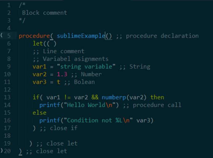

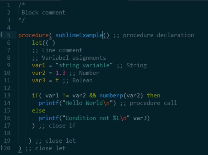

  • berndfi
    berndfi over 10 years ago
    Since the editor question is a never ending story
    and the built in SKILL IDE for me personally is not
    configurable enough I recently switch form "nedit"
    to "sublimetext" building my own SKILL highlighting
    scheme.
    If someone is interested in:
    http://www.sublimetext.com
    https://github.com/berndfis/SublimeSKILL
    Bernd
