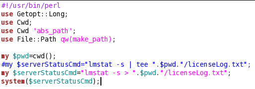

    I tried implementing this by calling a perl script through IPC. Perl script consists of a "system" function which executes the same 'tee' or the 'redirect' operator. Still it is not working.

    Jay,
    My point about using tee is that you're then producing a load of standard output which you're not consuming, potentially filling up the input buffer back to virtuoso. So I wouldn't do that if you just want a file. You could use
    cid=ipcBatchProcess("lmstat -s" "" "./licenseLog.txt")
    ipcWait(cid)
    Given that this is failing for perl too, I wonder whether the executable is failing with an error - perhaps your command could be:
    my $serverStatusCmd="lmstat -s > ".$pwd."/licenseLog.txt"." 2>&1"
    This would redirect any stderr to the file too - might give a clue as to why it's failing. Either way, doesn't sound like it's a Cadence issue - since you're using a non-Cadence executable (lmstat is from Flexera) and you're invoking it from perl...
