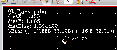

I find that sometimes the font size of the ruler is too small when at certain zoom points and would like to be able to change the size. Any help would be greatly appreciated. Thanks, Aaron

    As of IC615.500.2, it is not possible to change the ruler font size. We do have a few request for this. As a workaround, you can use the following script. It will display the measurements in the upper left hand corner of the window.

    Sample:
