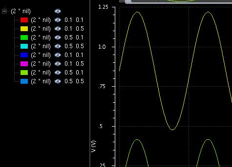

Greetings all,
I'm running IC6.1.500.6
I'm running into the problem where if I create a family waveform using the standard family waveform functions (famCreateFamily, famAddValue), it is creating plots that are not differentiated between each other in viva.
e.g.
a = family waveform created with famCreateFamily
b = family waveform created with famCreateFamily
c = 2*a
d = 2*b
plot(c d)
If I look at the plot that shows up, it lumps c and d waveforms into the same plot labeled  "(2*nil)"
I found that if I have a family waveform created with a getData() statement assigned to a variable (e.g. 'o_fam') I can pull it apart by using the command:
o_vec = drGetWaveformYVec(o_fam).
If I then query the o_vec, I can get something like:
o_vec->??
(units "" expression
    getData("/Q1C" ?resultsDir "/sim/fefan/bicmos8hp/beck_ma/TB_npn_distortion/spectre/__mod_VCB_tran_" ?result "tran")
If I try to pull-appart the family waveforms created with the famCreateFamily functions, I only get 'nil' when I query the y vector.
My assumption is that viva is looking at the expression embedded in the y vector and is grouping and labeling the waveforms based upon this.
My question:
Is there a way to set the expression of a family waveform y-axis vector?

    It should just be a matter of setting the expression property on the y-vector of the family. I don't know why that's not working for you, because it does for me:
    load("abMakeWaveform.il")
    xvals='(1.0 2.0 3.0 4.0)
    yvals='(-1 -3.0 2.0 5.0)
    w1=abMakeWaveform(yvals xvals)
    w2=abMakeWaveform(mapcar('add1 yvals) xvals)
    w3=abMakeWaveform(reverse(yvals) xvals)
    w4=abMakeWaveform(mapcar('times yvals yvals) xvals)
    a=famCreateFamily('temp 'double)
    famAddValue(a 27 w1)
    famAddValue(a 50 w2)
    drGetWaveformYVec(a)->expression="famA"
    b=famCreateFamily('temp 'double)
    famAddValue(b 27 w3)
    famAddValue(b 50 w4)
    drGetWaveformYVec(b)->expression="famB"
    plot(a b)

    Ah.... I see what I was misunderstanding.  I didn't realize that when you accessed the Y vector with the drGetWaveformYVec() command, you were directly modifying the original waveform vector.
    This is exactly what I was looking for.
