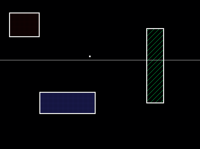

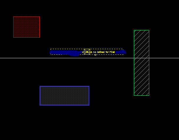

    I tried to make the problem more clear; I have one pcell which starts with something like:
    If( isCallable(theBigPcellFunction) then
        theBigPcellFunction(....)
    else
       put_an_error_marker_in_layout
    And I have the original layout with that pcell (which is only a marker because I did not loaded also the big function in order to have the possibility to make tha screenshot. I export to Stream; then I import the gds file back in Cadence, and I open it;
    the result:
    The Pcell which initially had only an error marker and a label to explain the marker, after export and import, it;s just ... somthing selectable but with nothing inside !
    This kind of cases I want to avoid.
    Thank you,
    Best Regards,
    Adrian

    dmay over 14 years ago
    The marker layer is a system layer and is probably not exported by default. If you want the marker to be there upon import, you'll need to make sure it is streamed out.
    If you don't want stream to continue, then you are better off just having your pcell fail on its own. Then the ignore pcell failure will work as intended. As it is, your pcell is created successfully with your own error output. You might need to put an error() command in the else statement to help trigger a real pcell failure.
    Derek
