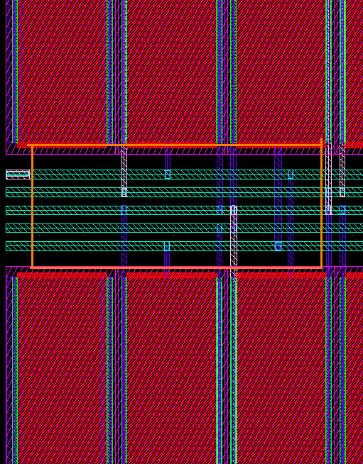

In several layout matching we  place the devices (nmos or pmos) in 1, 2 ,3,4,5 (rows)  etc and route through the empty space . so i would like to caluclate the empty area between the device through skill. layout is done in L editor with virtuoso 615 and we have many matched cells are in hierarchy level.

    yes i have a question, I have placed NMOS in 2 rows separated by some space in y direction between the mos (like modgen generate the matched module)  we route in pin to trunk manner where trunk is horizontal usually in metal2 through the empty space between the mos.
    I would like to calculate the area of the empty space using skill .

    Plese find the attachment. I am interested in find the area showing with marker.
    xcordinate of each instances are same.

    i have tried with this cv=geGetEditCellView() foreach(m cv~>instances if(caar(m~>bBox)==caar(m~>bBox) then ........ i have tried like this but i am stucked
    Andrew Beckett over 13 years ago
    Your code clearly wouldn't work because it's only comparing itself with itself.
    I'm assuming something along these lines would be what you're after:
    ; first collect a table indexed by the xCoord of the instance origin
    ; each entry is a list of all the instances with the same x coord
    sameXtable=makeTable('sameX nil)
    foreach(inst cv~>instances
      x=xCoord(inst~>xy)
      sameXtable[x]=cons(inst sameXtable[x])
    ; then find any entry in the table with more than one instance
    ; and sort them in yCoord order (using the bBox in case they've been flipped), and print out the gap
    ; in the bBox's (in the y-direction)
    foreach(x sameXtable
      insts=sameXtable[x]
      when(length(insts)>1
        insts=sort(insts lambda((a b) yCoord(lowerLeft(a~>bBox))<yCoord(lowerLeft(b~>bBox))))
        bottom=car(insts)
        foreach(inst cdr(insts)
          printf("Gap between %s and %s is %g\n" inst~>name bottom~>name
            yCoord(lowerLeft(inst~>bBox))-yCoord(upperRight(bottom~>bBox)))
