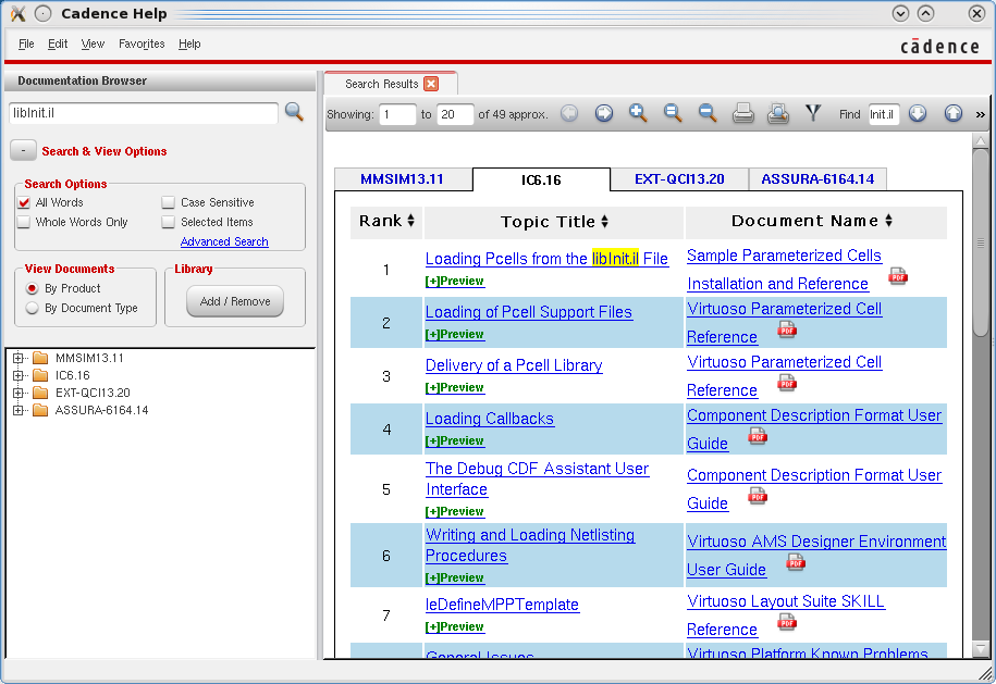

how could i use the "libInit.il" to add my own user-defined funtions when restarting the ICFB?
danglang
danglang over 12 years ago
I've already finished a pcell with skill language within which i've called some my own user-defined functions from some other docments.
So i load it like "load("xxx.il" in the CIW. OK! I've got my first DIY pcell.
 But when I restarted the icfb, i almost lost all what i''ve finished.
I have to reload all the "xxx.il" documents in th CIW. What a terrible thing!?
So how could deal with this problem?
ps: I've seen some examples talking about the use of "libInit.il" document, but I'm still confused about it.
thank you for your reply!
    Typically what you would do is to add a file called libInit.il in the same library that contains your pcells. So the file would exist at the root of the library. The file could either contain the function definitions, or have load() calls to load the code from elsewhere.
    That's it.
    You could have searched in cdnshelp for libInit.il and found this out.

    Lee,
    In IC5141, the documentation system is "cdsdoc". The tricky thing is that this is not supported on later operating systems, so often these days it doesn't work. I wrote a solution which tells you how to fix it (for RHEL5 and RHEL6), although I should point out that this is not "supported" (but it does seem to work OK!).
    You can also run "cdnshelp" and point to the IC5141 documentation tree, but you'll need to have write access to the installation in order to run "topicgen" to build the indexes. Once this is done once, you can easily use cdnshelp.
    So, if you have cdnshelp in say an MMSIM installation that you're using along with IC5141, you'd do these steps:
    cdnshelp -hierarchy <IC5141_instDir>/doc
    if the indexes (or rather indices) aren't there then it will prompt you to run topicgen. You'd do this (with write access to the installation):
     /export/home/apps/MMSIM131_isr/tools/cdnshelp/bin/topicgen -docset /export/home/apps/IC5141_isr/doc
    (note, the paths are my own).
    This takes a few minutes. Having done that, it will then allow you to run cdnshelp with the -hierarchy switch, or alternatively use the Edit->Setting and then Library tab to add the path to <IC5151_instDir>/doc into your search path for cdnshelp.
    Anyway, aside from that, to answer your specific question you could just look at <IC5141_instDir>/doc/pclib/pclib.pdf and search in there for some info on libInit.il (it's elsewhere too, but that's a good start).
