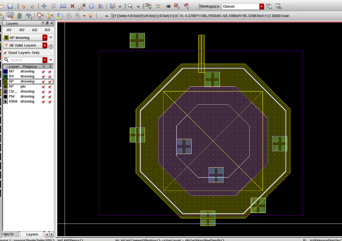

    The original code find only shapes outside prBoundary, could someone help to modify it to find vias/objects also. Please see picture below:

    after running the code, I got :
    CCSFindShapesOutsidePrBoundary()
     shape with bBox ((81.64 92.55) (85.31 115.49)) is outside prBoundary object
    (db:0x79c1611a)
    It catch one shape (yellow path on top middle of picture). It does not catch vias outside prBoundary, and does not catch shapes at the bottom, maybe not done in hierarchy way ??
    Thanks a lot,
    HP

    skillUser over 12 years ago
     Hi HP,
    The via objects are not found because they are not shapes but objects in the OA database.
    You might need to consider other approaches to finding all objects such as dbGetOverlaps().  You could also work with a flattened version of the layout, but that might work out cumbersome (copying everything to a scratch cellview, processing). Another approach could be to copy everything to a scratch cellview and Chop out the prBoundary rectangle which should also remove any content within the boundary, but leave behind anything that was outside or overlapping the boundary.
    Hope this helps?
