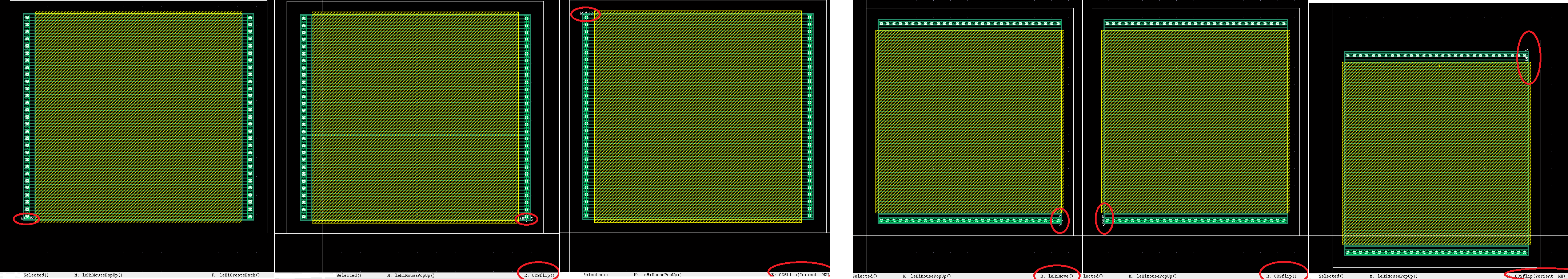

    Hi Andrew, For me it's not working as it should, e.g. if MX flip (F1 key assigned) is ok, then MY (F3) is not working ok, there is some offset, so the object is not flipped in place and when I rotate the same object for 90 deg with move and right mouse click, then MY is ok but MX it's not? 10x
    What you're describing is not very clear. It would help if you said exactly what function arguments you're using in your bindkeys, and showed some pictures (you can attach a picture using the Options tab on the forum) to illustrate the problem.
  • sPoK
    sPoK over 14 years ago
    Ok, I'll try to explain better now. I've assigned CCSflip() to the F1 key, and CCSflip(?orient 'MX) to the F3 in a my "BINDKEYS" file. When I place instance in the layout (eg 0.0 coords) with R0 original rotation (1st pic in pic) and hit F1 key instance is flipped and shifted to the left (2nd pic in pic). If I hit F3 (from org position - R0) then it's ok flipped in place without shifting(3d pip) Similar goes if instance is placed with R90 (4th pip) but this time F1 is working ok (5th pip), but F3 not (6th pip). It seems that somehow transform coordinate is not well calculated whether the instance is not symmetric? Thanx

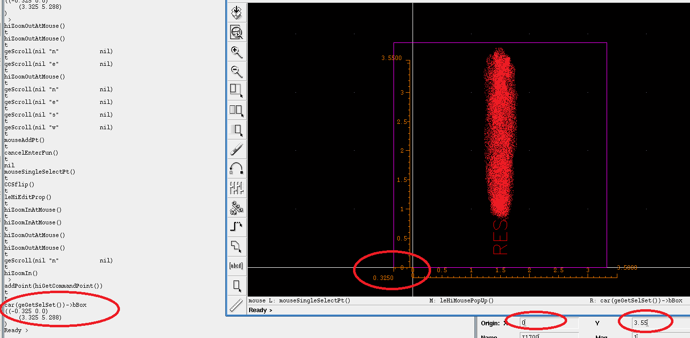

    Since the code simply uses the bBox attribute of the instance, it would suggest that the bounding box extends differently to the left and right of the instance. If you have the instance placed at the origin, maybe you can give a picture with the instance at full depth, and with the stop level set to 0 (on the Display Options form) so you see the outline of the instance? My guess is that the bBox (which you can check with car(geGetSelSet())~>bBox if you have the instance selected) is aligned with the visible shapes vertically, but not horizontally.
  • sPoK
    You were right, component bbox and origin are different. BR
