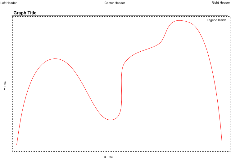

We want to export the simulation results through a script to guarantee some information to be included automatically on every plot. Also, as the design is finished the plot must be exported to an eps or pdf file, like the following example shows.
We tried using saveGraphImage and printGraph commands, with better results with printGraph as it lets define the header fields, the margins and orientation of the paper. And that was exactly what we want.
However, both of those commands use the ADE license, and the task must be achieved using only ViVA.  How can it be acheved using only ViVA?
Thanks a lot in advance.
Procedure used but checking ADE license.

    ViVA either runs with an ADE license, or a "ViVA XL" license (feature Virtuoso_Visual_Analysis_XL). The default behaviour is to check out the ViVA XL license if you have it if you run "viva" standalone - and then these functions work fine without needing an ADE license.
    However, not that many customers have these ViVA XL licenses - so even if you run "viva", it would still use an ADE license. If you were expecting this to run with no license at all, you'd be out of luck...
