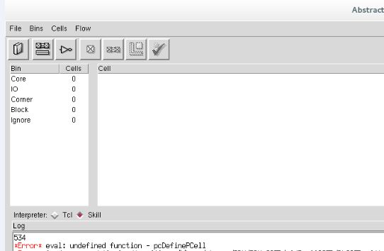

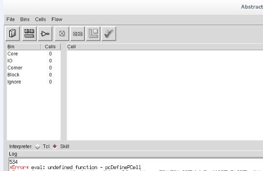

    Hi andrew, I have designed a simple opamp. Then I checked LVS and DRC. They are cleaned. But when I run "abstract" layout of the opamp circuit. Errors are happened. Like that: undefined function - pcDefinePCell
    *Error* load: error while loading file - "code_pcell/pcell_SoiMOS/mp_soi.il"
    *Error* eval: undefined function - pcDefinePCell
    And the via I created by Cadence Tool have an error: *Error* eval: undefined funciton - leDefineMPPTemplate... But these functions (pcDefinePCell, leDefineMPPTemplate) have already had in cadence tools. So, I do not know how to fix this problem. Could you help me solve this issues ?. Thanks

  • NguyenDinh
    NguyenDinh over 10 years ago
    HI Andrew,
    The program that I used to abtract show on the figure. Exactly, you said, I have load my pCell code from the lib.init file and have some warning like that "redefine". These warnings was cleand, when I just load my code once time. But the errors such as "undefine function - pcDefinePCell" are happened. Have you any solution for this problem?.
    Thankyou,
    Yes, I have a solution. As I said before, don't call pcDefinePCell from the libInit.il - this is not necessary (and in fact is bad practice, as usually users wouldn't have the permissions to redefine the PCells each time - all you need to have loaded are any auxiliary functions called from within the pcDefinePCell code block).
