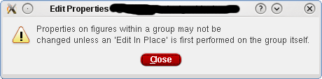

I am using IC6.1.6 for layout editing and sometimes I am getting warnings about group editing, like in the picture bellow, although I am not editing nor am I editing in place a group at the moment. The display option "transparent group" is off.
The problem is that this warnings are coming up 4 or 6 times consecutive. I am just at clicking away the windows. Especially when I am working through hierarchies.
Very annoying !!!
How can I get rid this warnings ?
Regards
Laurent
    Laurent,
    I can see this in the code, but I can't see how you can get to it - it seems that if the selected object is within a figGroup this appears. However, in the version I was trying, selecting an object within a figGroup (using SKILL) actually selects the containing figGroup instead.
    Which IC616 subversion are you using? Perhaps it was different in an earlier subversion than the one I was using.

    Hallo Andrew,
    I am using the sub-version  IC6.1.6-64b.500.12
    Regards
    Laurent
