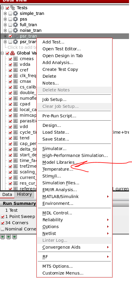

How to add menu items to test mouse right click menu in ADE-XL
Alex Stepanov
Alex Stepanov over 10 years ago
Is it possible to add items to test right click menu in ADE-XL using SKILL?
    The way to do this is to customer the ADE menus files (e.g. spectre.menus) - some of the menus are used to populate that RMB menu in ADE XL (e.g. the Simulation menu in ADE L), or the Setup menu (that's the one you're pointing to).
    There's some coverage of how to do this in this COS solution (this is attempting to avoid copying the entire menus file but to just contain the modifications to it and reference the standard menus file).
