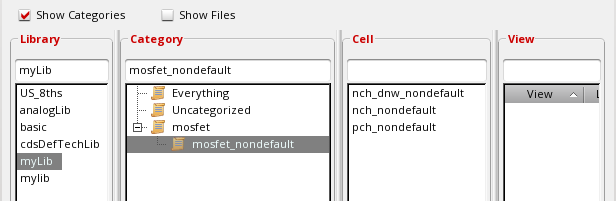

Hi All,
I am trying to create a sub category and copy over some cells from main category to sub category and rename it
I am following steps as below:
libName= "myLib"
ddId= ddGetObj(libName)
topCatId=ddCatOpen( ddId  "mosfet"   "a" )
subCatname="mosfet_nondefault"
subCatId=ddCatOpen( topCatId  subCatname   "a" )
Then I am getting list of cells I need to add to this new category. Those cells already exist in "mosfet" category.
finalCellList=list("nch"  "pch"  "nch_dnw")
After getting the cell names I copy schematic and symbol views of that cell in a new cell named <cellName>_nondefault.

After following all these steps when I look at the category list in library manager , I do not see the sub category. So basically category is not created ? or it's just its not visible in the list ?

    I just tried this, and it works OK for me...
    I emulated your code by adding the view type for the dbOpenCellViewByType functions (replacing the 4th argument from "" to "schematic" and "schematicSymbol" respectively) and also adding dbSave() before the dbClose (you wouldn't need to do this if the symbols/schematics exist already - I was just allowing myself to work from nothing), and adding cellList=nil at the beginning of the code somewhere:

    I tried your suggestions but still it did not work for me. Seems like it does create the library but its just not visible. I found some solution here
     (solution # 1835546) which tells if the category exist in library or not. I used it to find my new category and it did found it.
    Is there any display/visibility option which might be causing it ?
    I am using IC6.1.6

    Sanket,
    I believe categories are only not displayed if they have no contents. There's no means to hide them, as far as I  know.
    You can take a look at the category files in UNIX - they are text files - perhaps looking at them will reveal what is wrong?

    Was able to debug the cause for it. I was using ddCatOpen function. I was able to solve the problem by using ddCatOpenEx instead.
