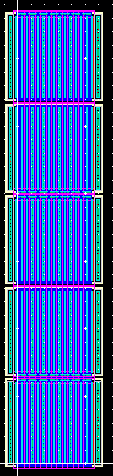

I have a pattern of transistor has DRC errors for some spacings between successive rows. These errors will be solved if i add rectangles for these layer. so instead of adding the same layer several times in the middle, i thought to add it only once with dimension of this layer in the whole pattern, like the NW layer specially they all share the same NW.
So what i thought about is:
1) Grouping the instances.
2) Accessing the needed layer.
3) Get its ll and ur coordinates.
4)Create rect with this layer and list of gotten points.
5)ungroup them again.
So i need a skill script does this sort of function.
Thanks

    ok i tried the leSearchHierarchy for a single transistor and it gives me 2 bBox values for the 2 PP layers used.
    But when i applied this to a pattern of transistor it gives me many bBox values but all are for the 1st transistor in the lower left corner.
    what i want is to get the most ll and most ur PP bBox for the whole boundary to be able to draw a PP rectangle to solve the in between spacing DRC error.
    Can you help me achieving this goal in a pattern shown blow know that i need the size of the PP rectangle changes with changing the pattern size?
    So i need a script the gets the bBox of the PP layer then draw a rectangle of this information a pattern
    Hope you get my point.
    Thanks
    Your requirements are a bit imprecise, so I'll provide some code which illustrates the principle. If you have a list of instances and a named layer purpose pair, you can use this code:
    *             CCFfindLayerExtentFromInsts(insts lpp)              *
    * Find the overall bounding box of a specified layer-purpose-pair *
    *                   across a list of instances.                   *
    procedure(CCFfindLayerExtentFromInsts(insts lpp)
        let((minLLX minLLY maxURX maxURY)
            foreach(inst insts
                ; Find the matching layer purpose and get the shapes on that
                ; layer purpose
                shapes=car(exists(LP inst~>master~>lpps
                    LP~>layerName==car(lpp) && LP~>purpose==cadr(lpp)))~>shapes
                ; For each shape, transform the bounding box up to the parent
                ; cellView's coordinate system, and pull apart the coordinates,
                ; comparing them against the min/max found so far
                foreach(shape shapes
                    destructuringBind(((llx lly) (urx ury))
                        dbTransformBBox(shape~>bBox inst~>transform)
                        minLLX=if(minLLX min(minLLX llx) llx)
                        minLLY=if(minLLY min(minLLY lly) lly)
                        maxURX=if(maxURX max(maxURX urx) urx)
                        maxURY=if(maxURY max(maxURY ury) ury)
            when(minLLX
                list(minLLX:minLLY maxURX:maxURY)
    You'd just (say) select the instances (to experiment with) and then do:
    CCFfindLayerExtentFromInsts(geGetSelSet() list("PP" "drawing"))
    This will return the overall bBox of that layer purpose pair in the list of selected instances. You could use this return value to pass to dbCreateRect to create the rectangle in the same region.
