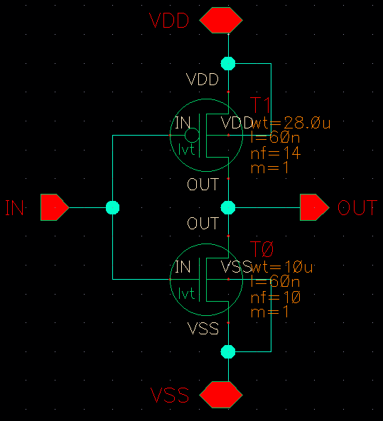

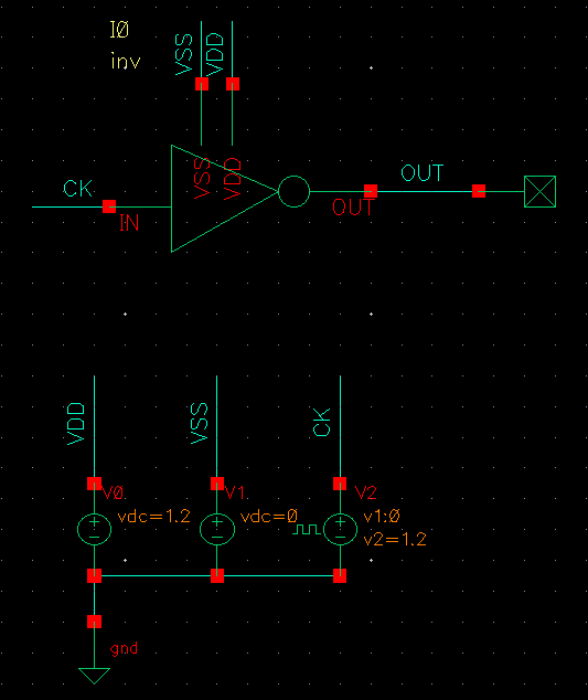

I have a test bench for just one inverter, as shown below:
I want to run postlayout simulation for this inverter, specifically want to save the current flowing into the drain of T0. The parasitics extracted netlist (in Spectre format) of the inverter contains 3 files, and was generated by Calibre xRC:
