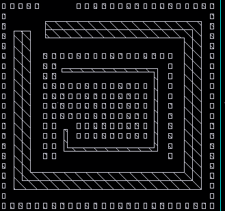

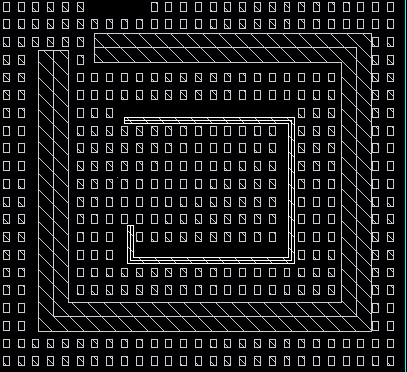

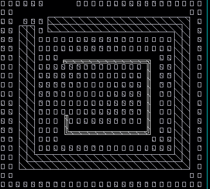

I generate many rod object on a area, I seek to delete some of them  which are at a given distance from another shapes drawing by a specific layer
Thank you for your help.
here my code:
procedure(delObjRulesSpac(cv rodList metalLayer spacingRule)
     let((direction rst)
         direction = '("top" "bottom" "right" "left")
         foreach(dir direction
             foreach(elem rodList
                  when(rodIsObj(elem)
                         when(elem~>dbId~>prop~>name == '("myProp") && elem~>dbId~>layerName == metalLayer
                                  rst = dbGetNeighbor(cv elem~>dbId~>bBox dir elem~>dbId~>layerName)
                                  when(rst
                                           dist = car(rst)
                                           when(dist < spacingRule  dbDeleteObject(elem~>dbId) )
1) Init situation
2) my result
3) reslut hope

    Hi Robert,
    Perhaps try a different approach, for example you could size up the path by your spacing rule (e.g. onto a temporary layer like "y0") and then find the rectangular shapes that are overlapped by the temp shape and delete those - it should make for an easier task.
    Hope this helps!
    Lawrence.

    Hi Lawrence,
    Thank you for your respond.
    In fact I had this idea, and I used the pcGrowBox function to size up my path
    foreach(shapes myCellView ~>shapes
    overLaps = dbGetTrueOverlaps(myCellView pcGrowBox(shapes~>bBox mySpacing) shapes~>layerName 15)
    when(overLaps dbDeleteObject(shapes)
    Thank you again
