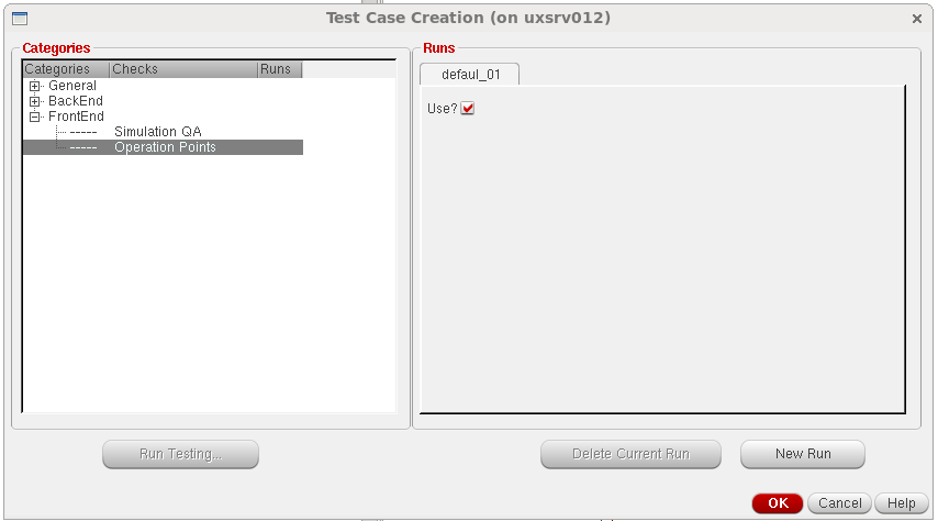

I want to dynamically change the labelText for farameField, is it possible?
I tray to change _labelOnly but it doesn't help.
For example (see attached picture), I want to see the name of the selected treeItem in the frame label text instead "Runs"

    Many fields cannot be adjusted once they are on the form. However, one easy way to achieve this is to have a similar 'duplicate' field with the alternate label and make one field invisible while making the other visible; the two fields can be displayed at the same coordinates but you will have callbacks to make sure that only one is showing at a time. When initially building these fields set one as visible and the other as invisible. In your case it sounds like this alternate field would be needed to be created dynamically; the same principle applies, at the triggering event (callback) create the replacement field and add it to the form at the specific location and make the original field invisible. You can delete fields and add fields to a form also but this can cause the form to 'flash' and is not visually appealing.
    Hopefully this helps?
    Best regards,
    Lawrence.

    Hi Lawrence!
    Yes, it can be considered as an option, but still it is not very desirable.
    In this case, delete and re-create can be even better.
    I'm just being able to eat a more convenient way.
