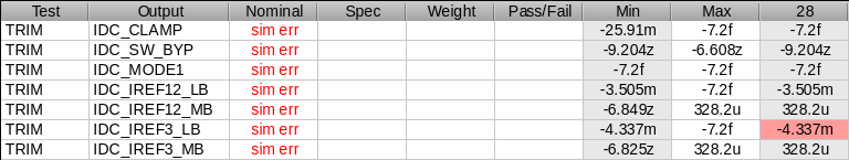

Hello:
I have a script that is setting up an ADEXL testbench and I am trying to set the spec for 2 different outputs on the same corner, however only the second of the 2 specs is getting set.  The first output, IDC_IREF12_LB, does not have a spec.  Is there a way to spec both outputs for a corner?
I also noticed that the Override Specifications... menu is always grayed out when I use this method to set the specs per corner but the one spec still shows up when that corner is ran.  It seems like it should be effectively the same as overriding the spec but as far as I can tell there is noway to view the spec unless you run the sim and then mouse over the result box for that output and corner combination.

axlAddSpecToOutput(sdb "TRIM" "IDC_IREF12_LB" ?range 0.0014033:0.001551 ?corner "28")
axlAddSpecToOutput(sdb "TRIM" "IDC_IREF3_LB" ?range 0.0017664:0.0019523 ?corner "28")
axlPutNote(sdb "corner" "28" "Other Parameter Corners: 29")
Results showing only the second of the two specs gets set.  I can set the other spec in a copy of that corner but that would double the number of corners and I have a lot of corners so it would be very useful to be able to set more than one spec per corner.

    I just tried this (in 6.1.7 ISR13) and it seems to work for me - effectively the ?corner should be doing the override specifications for a particular corner. Not sure why that would be greyed out?
    I was going to suggest you contact customer support, but see that you already did that - case 46194302 (a couple of days after posting here) and that the problem is now resolved (it's a bit of a mystery as to why it didn't work in the first place, but after restarting virtuoso you say it's now working).

    Hey Andrew:
    Yeah, that's correct, it seems to work fine now.  I meant to post an update the thread, just hadn't quite gotten to it yet.  Thanks for the reply!
