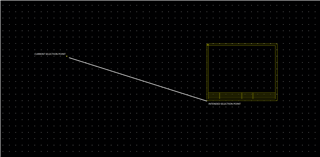

Hi all,
I'm using IC6.1.7-64b.500.15
Maybe this is a silly question, but I haven't found a solution for this yet. I'm trying to instantiate a custom border sheet (but it happens with any symbol, really) and the origin of the instantiation is far away from the symbol itself (see screenshot). How can I edit this such that the symbol is handled from its bottom left corner when instantiated? Sometimes when doing a fit in the schematic I find random instances lying around because of this issue.
    Did you try opening the symbol (or sheet itself) and doing Edit->Origin to move the origin of that component to where it makes more sense?
    It's a bit odd why you have this problem though. You need to be aware that changing the origin of the component would affect any existing instantiations of the component/sheet.
  • LuisGutierrez
    LuisGutierrez over 8 years ago in reply to Andrew Beckett
    Hi Andrew,
    Thanks for the answer. I fixed it using edit > origin. Question: How is the origin first defined in a symbol? I simply created the custom border sheet and first time I tried to instantiate it was already being handled from afar. Maybe a skill script triggered at check and save of the symbol that locates the origin to the bottom left of the bounding box is possible?
    Andrew Beckett over 8 years ago in reply to LuisGutierrez
    Luis,
    The trouble is that people often don't have the coordinates or axes shown in the schematic/symbol editor. These can be enabled via the Options->Display Options form. This isn't normally an issue because people usually start symbols from an existing symbol or using the Create->CellView from CellView forms which do pick one of the pins to be the origin. I can only imagine that you must have deleted all the contents and started drawing in free space? Or accidentally moved everything by an offset? It's not a problem I hear users complaining about in general, so I think it must be related to however you've edited them (or possibly something odd in your environment - but this seems less likely).
    Whilst it would be possible to have a save trigger to update the origin automatically, I think that could be rather dangerous if ever you've intentionally moved the origin to a more desirable location; it would affect any existing placements.
  • LuisGutierrez
    Hi Andrew,
    Thanks for the comments and extra hints. Definitely it makes more sense to have the sort of freedom for the origin definition the way you indicate.
