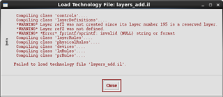

Hi All,
How to get the all the Layer# and Purpose# that are not reserved in the technology file using SKILL ?
Because I want to add new layers and purpose in my technology file by using SKILL,
I have a difficulty in finding the available Layer# and Purpose# manually in my technology file.
Please help.
Thanks in advance.
Best regards,
Marben
    Marben,
    This is covered in the documentation. In the Virtuoso Technology Data ASCII Files Reference, in the Technology File Layer Definitions chapter, in the section for techLayers, it says:
    x_layerNumber
    Number of the layer.
    Valid values: A unique integer from 0 through 194 and from 256 through 231-1.
    Note: Layers numbered 195 through 255 are system-reserved layers.
    There is a similar section for techPurposes:
    x_purposeNum
    The purpose number.
    Valid values: A unique integer, 1 through 128 and 256 through 232-65535.
    Note: Purpose numbers 129 through 255 are system-reserved. Purpose number 0 is also system-reserved and is defined as "unknown".

    Marben over 8 years ago in reply to Andrew Beckett
    Hi Andrew,
    Thank you very much for the clear explanation.
    It helps me find the Layer# and Lpp# that are not system-reserved.
    Best regards,
    Marben
