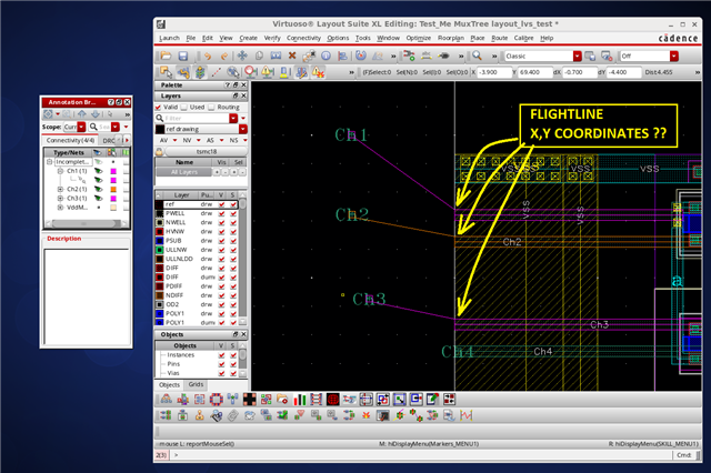

Hi All,
How to find the flightline ends coordinates in the layout generated by Annotation Browser using SKILL ?
Because I want to move the pins by using the flightline coordinates and SKILL.
Best regards,
Marben
    Hi Marben,
    The flightlines are all implemented using markers. You can find all the markers associates with pin objects this way:
    openToPins=setof(marker cv~>markers exists(obj marker~>objects obj~>pin~>term))
    From this you can find out the associated objects by looking at openToPins~>objects (one is the rectangle or other shape corresponding to the pin, and the other is the shape or instTerm which is the other end). You can also find out the ~>points for the marker. Look at the marker~>?? to see the available attributes.

    Marben over 8 years ago in reply to Andrew Beckett
    Hi Andrew,
    It works perfectly  !!!
    This is exactly what I need, this is a great help for me.
    Thank you very much.
