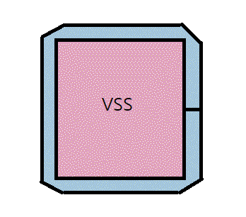

I'd like to make a layout cellview with CB layer for pad opening and its own pad pin from original layout so I'm using dbGetTrueOverlaps function.
There is an issue I cannot get full size of CB layer by using the function. Whole CB layer is octagonal shape but it is made of two shapes which are seperated with rectangle inside and rest of it outside. The shapes are abutting each other without any gap. But I only can get rectangle CB layer by using dbGetTrueOverlaps.
Do you have any good idea I can get whole CB layer?

    You didn't explain what the region of the rectangular area provided to the dbGetTrueOverlaps was. For me, if I provide the bBox of the pink area, it finds the blue shape too. If I provide a smaller rectangle…

    I can tell you dbGetTrueOverlaps will find polygons (not just rectangles) if they overlap the bbox you give it, and are on the correct lpp.
    But if you want the whole CB layer anyway, maybe you should try dbLayerOr?

    Alright. It's hard to explain it but let me try with this diagram again.
    The pink and skyblue shapes are all CB layer and they are abutted each other but separated shapes which are in a layout cell.
    And the VSS pin exists on the top level so CB layer and pin have different hierarchical level. I'd like to make a new cell existing CB layer and its pin on top level but I could get only the pink shape, not all the pink and skyblue shapes by using dbGetTrueOverlaps with VSS pin coordinates. Pad pin coordinates are not centered on CB now.

    You didn't explain what the region of the rectangular area provided to the dbGetTrueOverlaps was. For me, if I provide the bBox of the pink area, it finds the blue shape too. If I provide a smaller rectangle than the pink area, it doesn't return the blue shape (but it doesn't overlap in that case).
    So it's not clear how you're trying to find the shapes.
    Please ask precise questions as otherwise we all have to try to guess what you mean (or most likely you'll just not get an answer...)

    I provided VSS pin coordinates on dbGetTrueOverlaps only for getting the CB shape. That's why I couldn't get the full shape.
    I could get the full shape after making bigger size of bBox than pink area.
