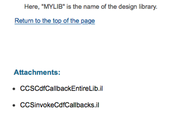

    I mean I am not getting the Skill code for
    CCSinvokeCdfCallbacks.il
    Andrew Beckett over 8 years ago in reply to FormerMember
    Scroll to the bottom of the article, and then you'll see:
