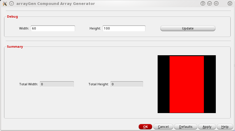

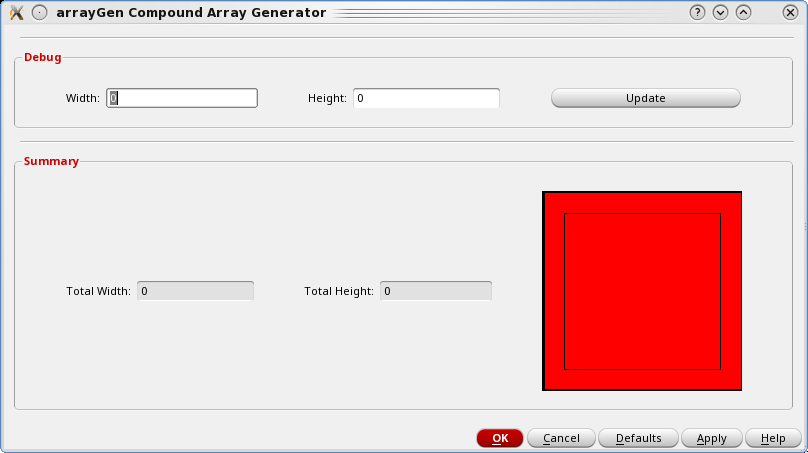

    When initially displaying the form, it appears like this (so the display list icon is clearly being used):

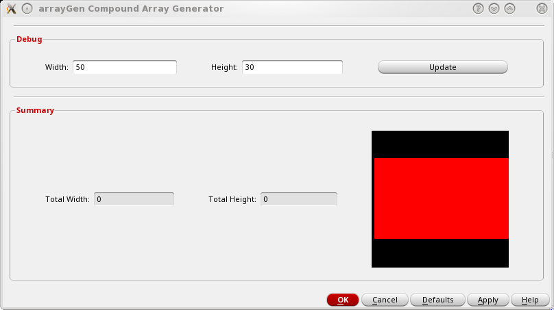

    If I enter some values in the Debug fields and hit Update, the form updates:
    Here's a second update:
    So I think it's just down to the statement above. I didn't quite get what  you meant about "just a black box" - for me before this tweak to the code, the icon remained as it did initially (the first image above).
