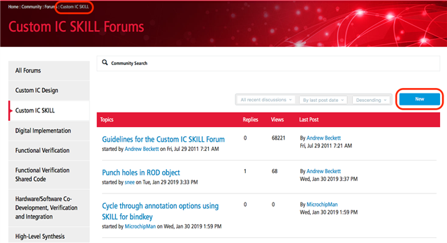

    First of all, it's easy to create a new post:
    The top ringed region shows you how to get to all the forum posts for a particular forum, and the second ringed region is the button for new posts.
    I split this into a new thread, and renamed the thread. This SKILL will do what you want.
