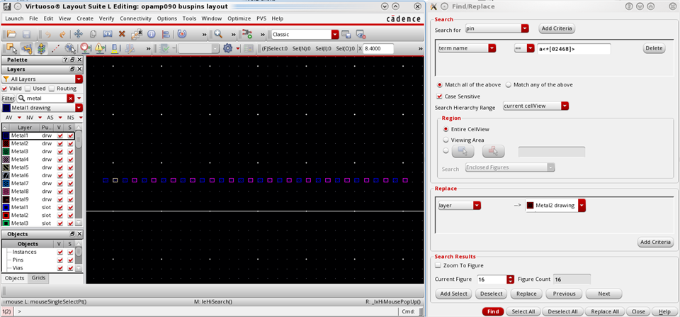

    Yes, I have series of pins in the layout editor. I need to change the layer of alternatives pins
    Andrew Beckett over 7 years ago in reply to Bala Sowjanya
    One way is to use the find command. For example, in the picture below, I have a bus of pins which was for a<31:0> - so there are 32 different pins a<31> through to a<0>. I then use Tools->Find/Replace and find them - I could select them or replace the layer directly on the form. I use the regular expression pattern to pick the even bits - could use a similar approach to pick the odd bits:
    If however your pins are just arbitrarily named and you want to select every other one, there's nothing really built-in to do that. It's easy to write some SKILL code to do it though. In this case, select all the pins (doesn't matter if you select non-pin objects too, because the code deselects the stuff you don't need) and then use this:

    You'd then use CCFdeselectEveryNthPin() or CCFdeselectEveryNthPin(?first 1) to offset by 1, or CCFdeselectEveryNthPin(?byY t) if the pins are arranged vertically. This requires no knowledge of the pin names - it's purely based on the ordering of the centre of the pins.
