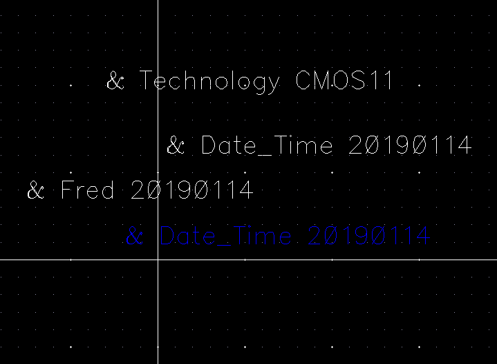

    No, I'm not going to provide my "gmail" id (or even my Cadence email address) in a public forum. I thought you had some data to run this on yourself? I simply created a bunch of labels on the right layer like this:
    The white labels (in my case) where on layer text/drawing and the blue label on Metal1/drawing (because I didn't have an IP layer in my PDK). I can then put the code above into a file (say  CCFupdateLabels.il) and then do (once):
    load("CCFupdateLabels.il") in the CIW
    After loading, I just do:
    CCFupdateLabels(?layer "text")  ; you could just run CCFupdateLabels() since the layer would be the right layer.
    Then the white & Technology and & Date_Time labels will get updated. The others are left alone.
