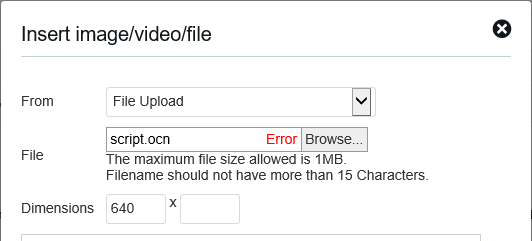

  • ExcaIibur
    ExcaIibur over 7 years ago
    I dragged and dropped 'script.ocn' and 'hello_world.ocn' here, but I can't tell if they have been successfully uploaded. If they are still not, please let me know.

    No, they've not been attached. I think I'd need to see the code to understand what you're trying to do. Not really sure what you mean by having this watchdog function watch over the math() function - they are in separate processes, so not sure what would be watching what.
    Try using Insert->Image/Video/File and then loading the file from the computer. it should show up in the post before you post so it should be fairly obvious that it worked. Drag and drop is mainly for images, not for other files.

    Unfortunately the uploading system seem to be unfriendly to me
    Let me try to do it the stupid way

    Not sure why you had a problem with the file upload - it appears to have worked fine for me.
