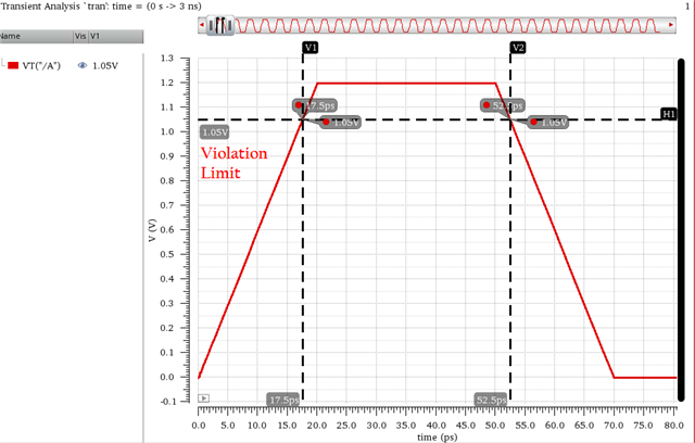

    oyayla over 7 years ago in reply to oyayla
    This is transient waveform for the above data

    Andrew Beckett over 7 years ago in reply to Frank Wiedmann
    The issue is because of how the assert is formulated. It's formulated as a boolean expression (like the second below) and so there's no "peak" because the expression is either 1 or 0. If it was implemented like either of the first or the third, then you get a peak shown:
    assert_nch_1 assert mod=gpdk090_nmos1v param=vgs max=0.8
    assert_nch_2 assert mod=gpdk090_nmos1v expr="V(g,s)>0.8"
    assert_nch_3 assert mod=gpdk090_nmos1v expr="abs(V(g,s))" max=0.8

    Andrew Beckett over 7 years ago in reply to oyayla
    Hi Yayla,
    Just noticed a mistake in my previous post (I got the order wrong - the first and the third show a peak, the second doesn't) - I've corrected the post.
    Anyway, the issue is not with the abs() (maybe my typo had confused things as I got the order wrong). The issue is that you have  an expression with >1.05. This means that the expression is a boolean expression and thus returns 1 or 0. If you use:
    // Core ulvt voltage assertions
    assert_pch_ulvt_vgs assert mod=pch_ulvt expr="abs(V(g,s))" max=1.05 check_windows=[tstart_assert tend_assert] duration=tduration_assert message="PMOS Vgs voltage exceeded beyond +/-1.05V"
    assert_pch_ulvt_vgd assert mod=pch_ulvt expr="abs(V(g,d))" max=1.05 check_windows=[tstart_assert tend_assert] duration=tduration_assert message="PMOS Vgd voltage exceeded beyond +/-1.05V"
    Then it should give you the peak, as the expression is then the voltage (or the absolute voltage).
  • oyayla
    oyayla over 7 years ago in reply to Andrew Beckett
    Thanks Andrew. I have changed the rules and everything works now. And I got it what you mean by "boolean expression" .
