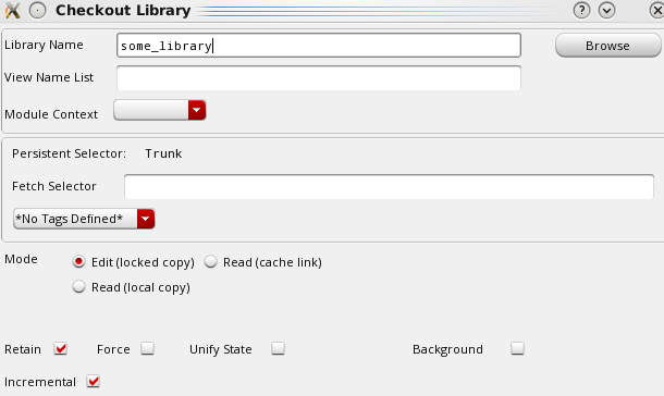

I found the functionality to check out all cellviews with the same name, e.g. schematic, under a library.
The GUI looks like this:
What I find it not so perfect is that it checks out data.dm of every cell, which I don't think is needed. I wonder whether I can tell the tool not to do this.
    That is not a form from a Cadence product. It's most likely part of whatever Design Management solution  you're using, so you'd need to contact whichever vendor you're using. They will have implemented an interface in Virtuoso, which is why it looks like a Virtuoso form, but the code itself is developed by the third party connections partner.

    Thanks Andrew. I will ask around.
