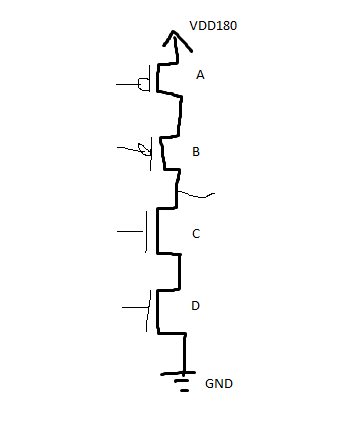

    Above script gives the devices connected to any net, So this would change the devices that are connected to VDD180 as in my situation here. Not let us take an example of the below schematic. According to the above procedure it will change the device A and D , How would I be able to find the devices B and C(It is a dummy schematic, It might have series of resistance and capacitance in between)
    Thanks
    Utkarsh

    RiadKaced over 6 years ago in reply to Utkarsh Arora
    Hi Utkaresh,
    I'm not sure I understood ... If you run the procedure as following (Change libName/cellName for the actual names):
    FTTgetDevicesConnectedToNet('("libName" "cellName") "VDD180")
    The above command will only get MOS A as it is the only one which has a pin directly connected to VDD180, and probably B as well if its bulk is connected tp VDD180. It won't change device D though. Anyways, I'm not sure I understand what you actually mean. The best way is for you to lay out a clear spec instead of feeding bits and pieces of information over time, it's easier to put down a clear spec of the criteria of what/when you want to change a device.

    What about device B? What if you have transistors A, B, C, D, E, F, all stacked between VDD180 and GND, which ones would you change to the 1.5V ?
  • Utkarsh Arora
    Utkarsh Arora over 6 years ago in reply to RiadKaced
    I have to change them to a higher voltage. So if all are stacked between VDD150 and GND all fets need to be changed to a new flavor that supports VDD180.
  • RiadKaced
    In this case you have to adapt the SKILL code I shared and trace the stack down from VDD to VSS, keep track of all transistors in a list then perform the changes on those transistors only. Again the idea is to build your own code that first collects the transistors that fit the change criteria then apply the changes. The SKILL codes I provided should be sufficient.
