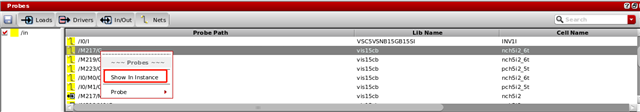

there are some code in the subProcedure "reportCB"  to find specific instance and report it.
in last week I try many ways ,but I cannot get the right path.
OR is there any function can open it ? just like "show instance" in probe assistance,like below.
If it is ok, should I use hiCreateReportField?
I am use "sub-version  IC6.1.7-64b.500.21 ".

    Hi Andrew,
     I just want to find specific Instance and it's corresponding path (for convenience, I can find the specific instance in schematic) throuth skill in schematic.
    until now, I can realize the step one,but I cannot find the correct path throuth my skill code which I posted above.
    I tried many ways means that I modified many times on my code which I posted above, unfortunately I still cannot make it.
