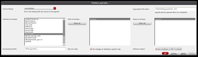

In our team we make a hierarchical copy of our individual blocks for the final library in a tapeout. I'm using some pcells that rely on code in the libInit files. However, the hierarchical copy copies only the cell, obviously not the needed code in the libInit file. Is there a way to automatically flatten (or something else) these pcells to have a truly standalone library (without other team members needing access to the original pcell library with the respective libInit files)? This is not necessarily a question about SKILL, if there is something implemented in virtuoso I'm happy to use that.
Kind regards,
Patrick
  • Sheppie
    Sheppie over 6 years ago
    Hi Patrick,
    If I understand you correctly, you want to flatten instances from a certain library in the entire design.
    Some code I wrote at least 10 years ago (with limited SKILL experience, so it could be written more efficiently) does just that: it looks for instances (pcells) from a specific library in cells in a library and flattens them. In stead of it being just floating polygons, all polygons from the pcells are grouped, and the parameter values of the original pcell are attached to the group for future reference.
    I needed to do this since a colleague of mine wrote some pyCells (Python P-Cells) and the Python version he used was not supported by Virtuoso after an update. See the attached file, and load it in CIW:
    Fullscreen 3288.flattenPycells.il.txt Download

    ;;; Building the GUI form...
    procedure( FPCBuildGui( theLibList "l" )
    	let( ()
    		FPCSourceLibrary = hiCreateCyclicField(
    			?name			'FPCSourceLibrary
    			?choices		theLibList
    			?prompt		"Source library:"
    			?callback		"FPCSourceLibSelectedCB()"
    		FPCSourceLibraryLabel1 = hiCreateLabel(
    			?name 			 'FPCSourceLibraryLabel1
    			?labelText 		"This is the library with the source of the pycells."
    			?justification 	'left
    			?enabled		t
    		FPCOutputFileName = hiCreateStringField(
    			?name			'FPCOutputFileName
    			?prompt		"Log output file name:"
    			?value			"flattened_pycells.txt"
    			?defValue		"flattened_pycells.txt"
    			?callback		"nil"
    			?editable		t
    			?enabled		t
    		FPCOutputFileNameLabel1 = hiCreateLabel(
    			?name 			 'FPCOutputFileNameLabel1
    			?labelText 		"Log-file will be opened after run completes."
    			?enabled		t
    		FPCLibsToBrowse = hiCreateListBoxField(
    			?name			'FPCLibsToBrowse
    			?choices		theLibList
    			?callback		"FPCLibsToBrowseSelectedCB()"
    			?prompt		"Libraries to browse:"
    			?multipleSelect	t
    			?enabled		nil
    		FPCCellsToBrowse = hiCreateListBoxField(
    			?name			'FPCCellsToBrowse
    			?choices		list( "Select libraries to browse..." )
    			?callback		"FPCCellsToBrowseSelectedCB()"
    			?prompt		"Cells to browse:"
    			?multipleSelect	t
    			?enabled		nil
    		FPCSelectAllCells = hiCreateButton(
    			?name			'FPCSelectAllCells
    			?buttonText		"Select all"
    			?callback		"FPCSelectAllCellsClickedCB()"
    			?enabled		nil
    		FPCViewsToBrowse = hiCreateListBoxField(
    			?name			'FPCViewsToBrowse
    			?choices		list( "Select cells to browse..." )
    			?changeCB		"FPCViewsToBrowseSelectedCB()"
    			?prompt		"Views to browse:"
    			?multipleSelect	t
    			?enabled		nil
    		FPCSelectAllViews = hiCreateButton(
    			?name			'FPCSelectAllViews
    			?callback		"FPCSelectAllViewsClickedCB()"
    			?enabled		nil
    		FPCGroupNamePrefix = hiCreateStringField(
    			?name			'FPCGroupNamePrefix
    			?prompt		"Groupname prefix:"
    			?value			"flat_pycell_"
    			?defValue		"flat_pycell_"
    			?callback		"nil"
    			?editable		nil
    			?enabled		nil
    		FPCDryRunOnly = hiCreateToggleField(
    			?name 			'FPCDryRunOnly
    			?choices		list( list( 'dryRun "No changes to database, log-file only." ) )
    			?prompt		"Dry-run only:"
    			?value 		'( t )
    			?defValue 		'( t )
    			?enabled		nil
    		FPCVerboseOutput = hiCreateToggleField(
    			?name 			'FPCVerboseOutput
    			?choices		list( list( 'verbose "Also feedback in CIW if enabled" ) )
    			?prompt		"Verbose output:"
    			?value 		'( nil )
    			?defValue 		'( nil )
    			?enabled		nil
    		;;; Building the form...
    		hiCreateAppForm(
    			?name 			'FPCGuiForm
    			?formTitle		"Flatten pyCells..."
    			?callback		"FPCFlattenPyCellsCB()"
    			?dontBlock		t
    			?fields		list(
    							list( FPCSourceLibrary			10:10		200:30		150 )
    							list( FPCSourceLibraryLabel1		150:30		290:30		150 )
    							list( FPCOutputFileName			910:10		440:30		150 )
    							list( FPCOutputFileNameLabel1		1055:40	295:20		150 )
    							list( FPCLibsToBrowse			10:90		440:200	150 )
    							list( FPCCellsToBrowse			460:90		440:200	150 )
    							list( FPCSelectAllCells			460:110	130:30		150 )
    							list( FPCViewsToBrowse			910:90		440:200	150 )
    							list( FPCSelectAllViews			910:110	130:30		150 )
    							list( FPCGroupNamePrefix			10:290		440:30		150 )
    							list( FPCDryRunOnly				460:293	440:30		150 )
    							list( FPCVerboseOutput			910:293	440:30		150 )
    						) ;;; end list ?fields
    			?buttonLayout		list(
    							'OKCancelApply
    						) ;;; end list ?buttonLayout
    			?buttonDisabled	list( 'OK 'Apply 'Help )
    			?unmapAfterCB		t
    			?initialSize		1400:600
    		) ;;; end hiCreateAppForm
    		;;; Displaying the form
    		hiDisplayForm( FPCGuiForm 125:125 )
    	) ;;; end let
    ) ;;; end procedure FPBuildGui

    Download the file and remove the .txt from the filename (this forum does not allow for uploading of .il files). To open the GUI simply type:
    flattenPycells()
    This will open this GUI:
    Then do the following:
    1. Select the source library for the pcells (this is the library of all pcells you want to flatten, if you have more source libraries, you have to run this script multiple times)
    2. Select all libraries in which you want all pcells to be flattened
    3. Select all cells in which you want all pcells to be flattened
    4. Select all (layout) views in which you want all pcells to be flattened
    5. you might want to change the groupname prefix...
    At first I advise you to enable dry-run mode. That way you can verify your settings (reading the log-file) before actually flattening anything. And just do it with one cell, so you can quickly see what is done.
    If you don't trust this code (which is perfectly fine), I suggest you make a full copy of the library in which the cells are that you want to flatten. Make this copy using Cadence, no Linux copy. And then use this script to test it on this copy. That way, if things are not working as expected, you're not in trouble.
    I just tested the code in Virtuoso 6.1.8, on an unmanaged database. If you have to do this on a managed database, first check-out all cells.
    I hope this helps.
