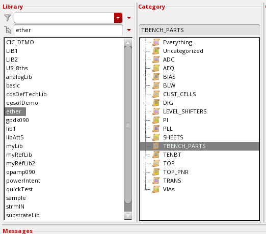

    So in the above example, if I use:
    cats=abGetExistingCats(libId)
    ("ADC" "AEQ" "BIAS" "BLW" "CUST_CELLS"
    "DIG" "LEVEL_SHIFTERS" "PI" "PLL" "SHEETS"
    "TBENCH_PARTS" "TENBT" "TOP" "TOP_PNR" "TRANS"
    "VIAs"
    Now you can see it's filtered out the two which returned nil and don't really exist on disk. As you can see from the screenshot here, this is what the library manager shows:
