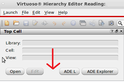

Hi Adrew,
Is it possible to add items to the Hierarchy Editor (config file) tool bar? Not even I can see that option in the Toolbar Manager (Virtuoso -> Options -> Toolbars) in order to add it manually.
Thanks,
Ivick
    Ivick, I split this from the original post because it was a) on the end of a 5 year old thread, and b) only had a loose connection with a question about adding buttons to an ADE toolbar. This will make it easier to find for others.
    There's a trigger (since IC618/ICADVM181) which allows you to register a function which is called when the hierarchy editor is opened, and this can be used to either add something to the existing toolbar, or add your own toolbars. It's not done using the Toolbar manager, since that's for "DE" (Design Editor) windows, and HED is not one of those. Here's how to add a new item to the existing toolbar:

    Thanks a lot for your reply, unfortunately I am not able to test it because my IC version says *Error* eval: undefined function - hedRegUICustomFunc. Eventually I think I will be upgraded and I will test it.
    In the meantime I would like to ask you the following in order to find a way to add a custom task to the HED:
    1. Is it possible to add a custom menu to HED  by using eRegUserTriggers()?  if so what is the t_viewType value for HED.
    2. Is it possible to add a custom button to the "Top Cell section"?
    Thanks and regards,
    Ivick
    Andrew Beckett over 6 years ago in reply to ivick
    Ivick,
    1. deRegUserTriggers doesn't work because the hierarchy editor is not a design editor window. That's precisely why we added a trigger function specifically to do HED-specific initialisation/customisation.
    2. No, you can't do that. The docked assistant in the windows is not a SKILL-generated form and so you cannot customise it.
