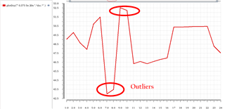

    The output of the procedure will be a wave. I have attached all procedure for the duty cycle. I have some pcreMatchList and setof functions to filter clock or/and to look at some signals only in a block. In the below example, My block name has "dcc" word inside so I am looking at duty-cycle of all toggling signals inside that cell without writing 24(signal number, x-axis in below image) output expressions with a single expression. Then, I am only looking at the outliers.
    Note: There is a linspace function inside which is a custom one similar to matlab's linspace function.
