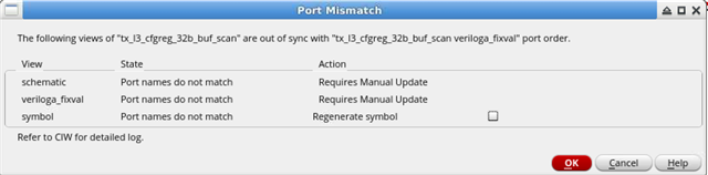

I am doing batch compile of veriloga views, and getting a "Port mismatch" popup window.
I am using currently ahdlUpdateViewInfo function for VerilogA but I tried also vmsUpdateCellViews and getting the same popup
How can I prevent it from appearing or auto-cancel it?
I found this topic:
https://community.cadence.com/cadence_technology_forums/f/custom-ic-skill/36380/suppressing-hdl-parser-warning-and-port-mismatch-warnings/1348507
But setting
envSetVal("schematic" "disablePortOrderPopup" 'boolean t)
envSetVal("schematic" "vicCheckPinOrder" 'boolean nil)
vmsCrossViewCheck=nil
Does not prevent popup window.
I tried also:
schHdlCrossViewCheck = nil
vmsUpdateSymbolAfterEdit=nil
AHDLUpdateViewInfo=nil
vmsRunningInUI=nil
With no success.
Thanks!

    I think it depends which popup it is. One of them can't be suppressed, if I remember rightly - so it's probably best to understand precisely what you're doing and then we can see how to fix/workaround it.
    Perhaps you can contact customer support?

    It should be easy to reproduce. If you have a cell with a schematic view and veriloga view with different ports, and you calling
    ahdlUpdateViewInfo(destLib ?cell destCell ?view destView)
    There will be this popup:
    I can, of cause, contact support. But from my experience they not very helpful in cases like this.
